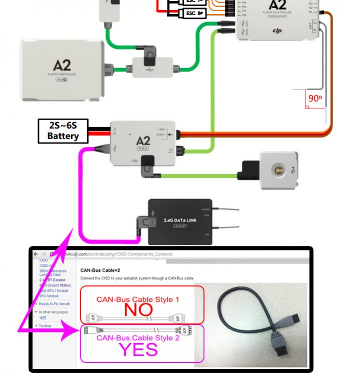

Hi Kaptankaos,
I made the following diagram to show you exactly how my 2.4 ghz datalink is hooked up to my A2 (and verified working during yesterday's test flight). I took snapshots of a couple portions of DJI literature and highlighted in pink exactly where I plugged in and with what type of cord. It appears that DJI has at least two different types of "CAN-Bus" cables. They might have the same wiring or "pin" layout internally, but it is certain that the connectors are different. I have tried to search for the actual terminology of these connectors in order to differentiate between the two styles intelligently, but I have come up empty handed -- so in the meantime I will call them by what differentiates them simply visually: by whether or not the connector has one of those locking clip tabs. Therefore, until I come across the proper nomenclature, I will call the two CAN-Bus cable connector types: tabbed and "tab-less". You will need one of the tabless cords to connect to this part of the A2's PMU, because as you can see the receptacle does not take a tabbed connector. Now here is the part where I feel bad: I have NO IDEA where I got this cable from. I have lots of DJI products and just happened to have one of these tabless connectors laying around in my toolbox. I will continue to try to find out where you I got this cable from or where you can buy it from. I hope this helps, I can feel your frustration because I have been there before. You just want the dang thing to work so you can have fun. Since these forums have been so much help for me, I really want to return the favor and help you figure this out! I couldn't figure out how to make the picture larger on this site so I uploaded it to my work site, view the larger picture at this link http://www.lyonmfg.com/djicanstyles.jpg

Thank you. Your post made me think this through a little deeper. I figured there is no place to plug in the air station to can bus two with everything hooked up. I thought why not take the chance and just unplug the BTU from the PMU and use the port as a test, worst case I may get an alarm. Go Figure...It hooked up right away and the simulator also works. So now I need either a can bus hub or a cable like yours.
I do not understand why the DJI folks would think it can be hooked up to any can bus. It only works on Can Bus 2 as in the original set of prints. The newer version prints and information directly from DJI support are wrong!!!!!!!!
IT WORKS!!!!!!!!!!!!!Yippee!!!!!!
Great to hear, and good thinking. If I were you, I would definitely not sacrifice the BTU, primarily because you would be cutting off the main method of the system communicating with you and/or warning you (the LED). The hub will add weight, but might be easier to find than the cord. I buy everything from IntelligentUAS (1-855-YES-1UAS). Give them a call, ask for Doug, and tell him Brett Lyon sent you. I have spent approximately $20,000 from them and have called them so many times I feel like they are a part of my family by now.
