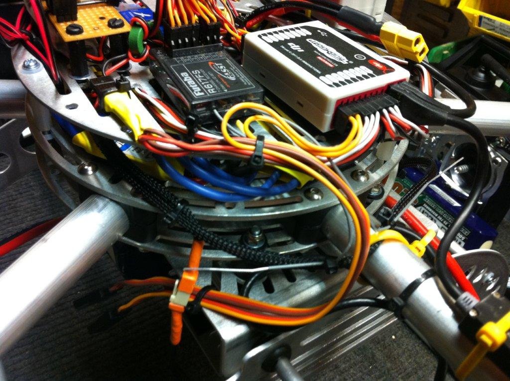

Yes, just the orange (signal) wires go into F1 and F2. The power wires go into a ubec powered from the SAME battery as the IMU etc. I made that mistake and the servos didn't work.
