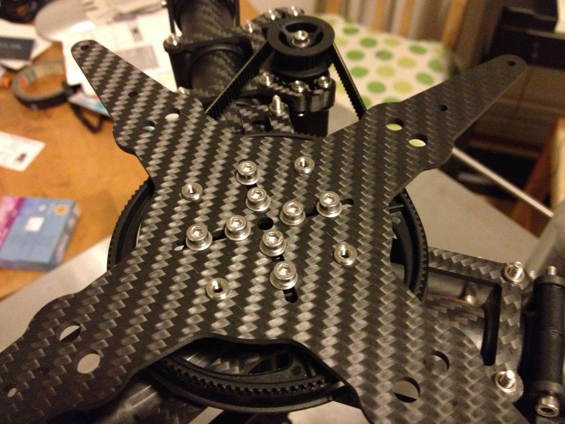

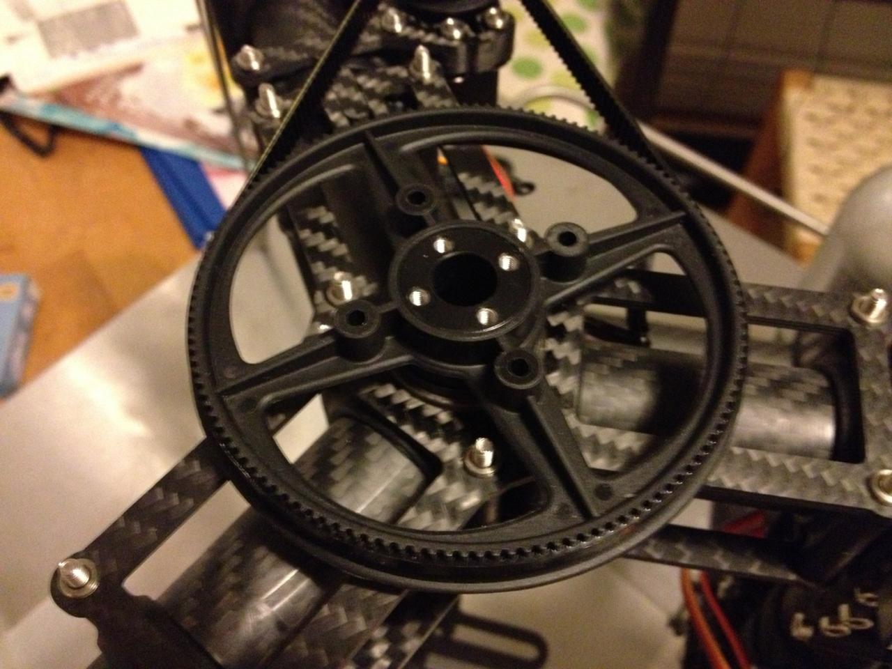

An old thread brought to life :) After watching the Cinestar 3 Axis Gimbal Tutorial and comparing it with the pan assembly I have, there seems to be difference in the two. In the pan wheel that is.
As a result, I see no need in installing the supplied four metal spacers as the outer four screw holes are on the same level with the inner ones. I just need to screw the longer screws to the outer holes and the shorter into inner ones. Is my plate installed correctly? Thanks!
View attachment 10422View attachment 10423

the plate is on right except it's upside down. if you did you can thread in a boom clamp and hang it if you need to work on it.
