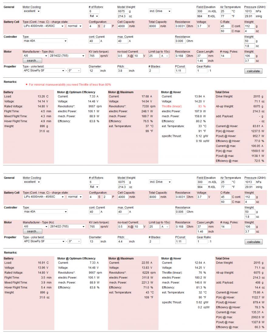

I've been using APC slowfly props for years but balancing them takes a lot of time. Especially SF Pushers seem to be a lot worse than normal SF's. I'd like to switch to well balanced CF props to avoid balancing and would like to hear opinions on brand and size. My setup is the following:
Hexa frame
6x AXI 2814/22 765kv
2x 4s 4000 batteries
Flying weight with camera: 6075g (13.4 lbs)
I currenctly fly with APC SF 12 x 3.8 props but e-calc suggests they are too small for my setup. I have had nice results with them so far and there seems to be more power reserve than e-calc says there should be. I'm wondering if I should switch to 13 or 14 inch props to have better flight time and efficiency? For example these:
http://flyduino.net/Tiger-1344-Carbon-Fiber-Propeller-CW-CCW-V2_1
E calc shows decreased hovering amp draw (see attached image). What are your opinions on T-Props? Anyone with similar setup, which props have you found to be most efficient and well balanced?

Motors and ESC's are warm after flight but not hot. I have a custom frame that can fit 15 inch props. I did some calculations with ecalc that suggest that my motors are really too small for my setup and cannot handle bigger than 13 inch at that flying weight. Otherwise peak amperage goes way over the 25A limit at max power. Trying 13" could bring slight increase in efficiency but really it seems that the best option would be to swap to bigger motors, props and 6s.
The setup you recommended on 6S seems to be ideal with quite a big increase in flight time. It's a shame I didn't know ecalc exists when I started to build my hexa. These new KDE motors would probably be quite similar to Avroto 3515? I've heard they have some incombatibility issues with SimonK so would need to get new ESC's as well.. Have you had sync loss problems with Avroto?

I'll try the 13x4.4 T-Props with my AXI's and try to get a good deal of either Avrotos or KDE's when we hear more test results about them.
