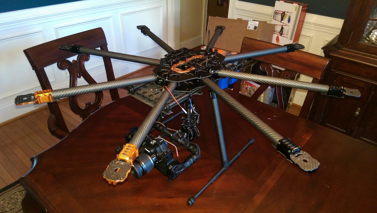

I've just finished mounting my DYS Eagle Eye / CAME 7000 gimbal to a new Tarot T15. There was no way to mount the gimbal using off the shelf components, so I had to draw up and have fabricated a top and bottom mount.
SKY-FLIX
A quick first test of the basecam controller. Not too shabby. Just some minor tuning on roll should sort it out. Also need to do a proper acc calibration on both imu.
