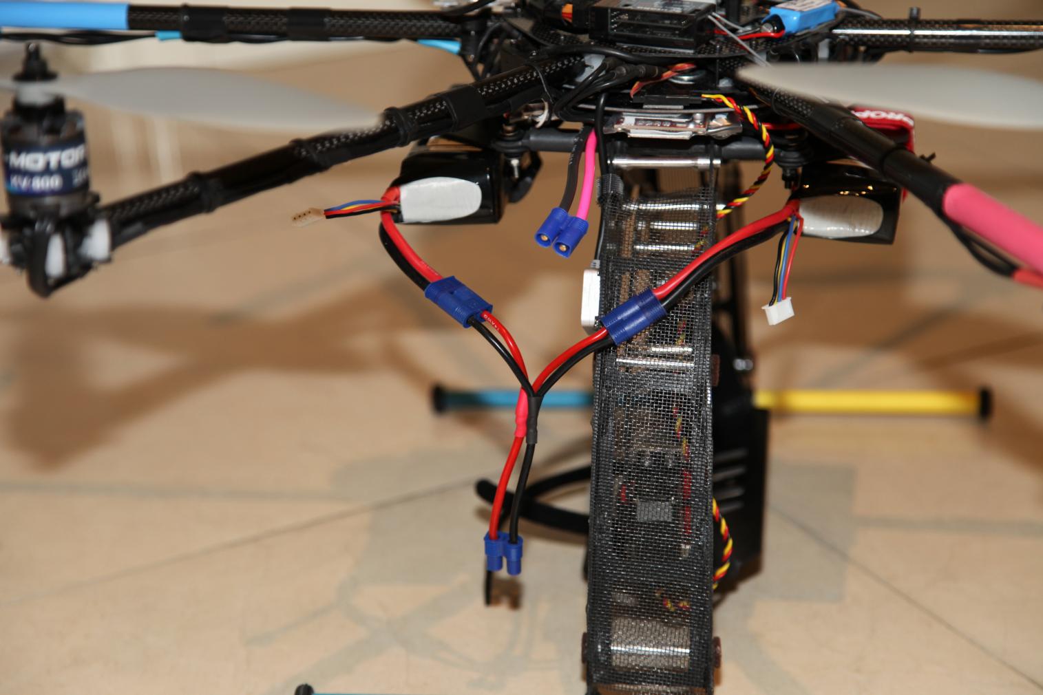

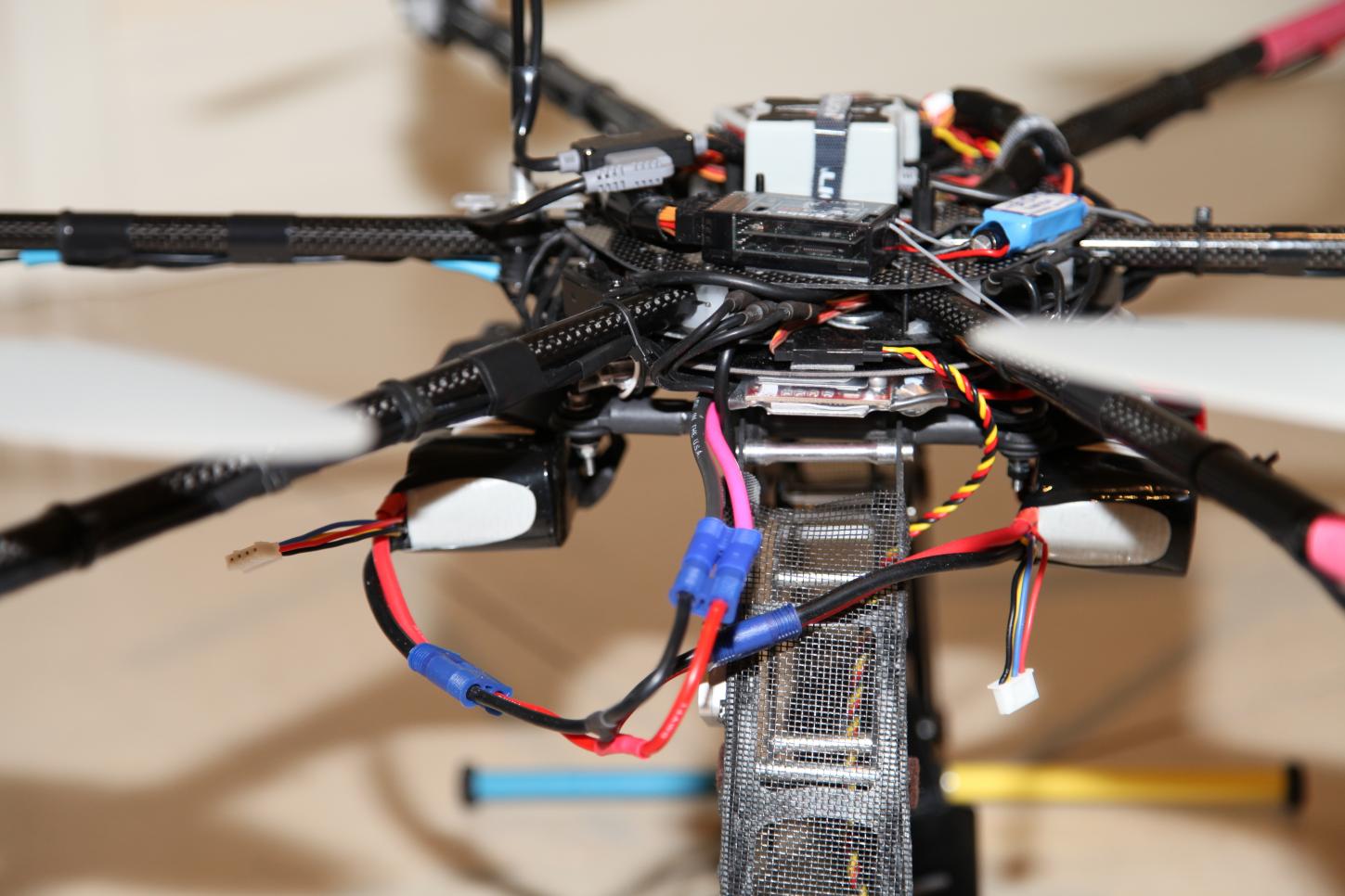

Hi Paktazh,
Here you go…! I'm attaching some pictures of mind, also give you the link to Hobby King ( base on their product code EC5) http://www.hobbyking.com/hobbyking/...ry_Harness_12AWG_for_2_Packs_in_Parallel.html is too big, mind is EC3 (it's call lead connectors )
Shiu
View attachment 3884View attachment 3885
