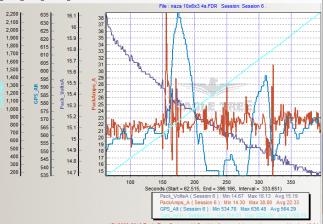

well that's night and day better. gonna have to try it in the wind to see if it wobbles then, noticed theres a big gap between a working gain setting and wind affects. She climbs a little slower than the 10x5x2 or the 9x5x3 on 4s, but shes super steady and i think looks like less vibes than before. sure is quiet, gets up over 20 feet up and i can't hear a thing. it maxed out at 24 amps total, the other 2 combos ran in the low 30's max. it is noticeably less powerful but i think a keeper. Will see how the new motors deal with it

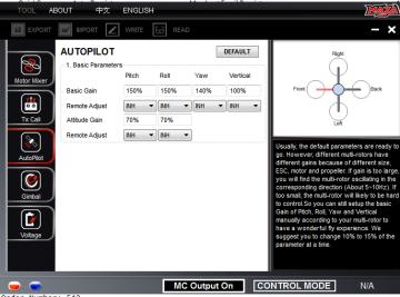

So i took it out and did a manual mode punchout, that's alot more like i was thinking it'd do, 48 amps total. in atti, it's alot less. this things a rocket in manual, eh? should seen it coming down. then i threw it in atti and took it up, the gps altitude showed going from 540 feet to 770 feet, all by eye. Can't wait to go to the desert and cut this thing loose, this is gonna be fun
The wind sure shoves it around though. gonna post my vid in a few, see if anybody's got any gain advice
theres the flick. i did alot of up and down a hill trying to get a feel for it, when i'd break cover and hit a wind going up, you can almost see it hit like a wall. Anytime theres a breeze, it gets all wobbly. That too high gain? Flies bitchen in the calm

Raise the basic gains a bit and lower the ATTI gains. Last flight I had the basics set for 150 and the ATTI at 70, smoothest flight I had so far in wind and also very nice for calm air and flying in manual.

that vid was at 150-150 but 105 on atti, dropped it down to 70 and will go give it a shot.
well, now i'm all locked up, not sure which avenue is best. Just made 5 flights on 4s with the 10x6x3 and that's bar none the best it's flown yet. When it bobbles coming down it's a little smoother and a lot less. Picked up a little jello, but that's gotta be my cheap balancer, got a top flight on the way so that'll get taken care of shortly
