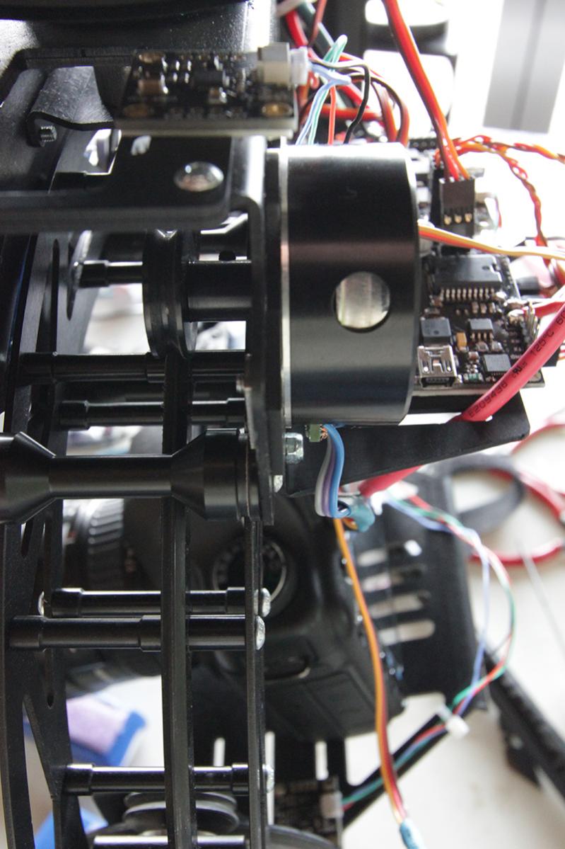

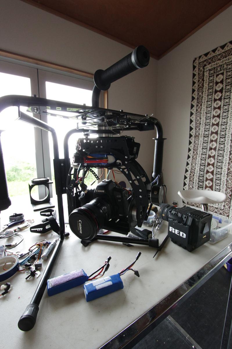

Are you using the same reduction gears from the stock AV200 on all 3 axis? Can you offer some images o your setup? Is it difficult to balance the roll axis with the weight of the motor? Any photos of the set-up woul be great. It seems like it will be a fairly straight forward conversion. Nice example video by the way.
Booma
Hi Tahoe
I will post some pics of the setup when I get a minute.
DSLR seem to balance fine, there is just enough width in the tray to allow the camera to be shifted a little to the right and offset the weight of the motor - because of the reduction gears balance is not quite as critical as for a direct drive system, it is still very important but there is some room for error.

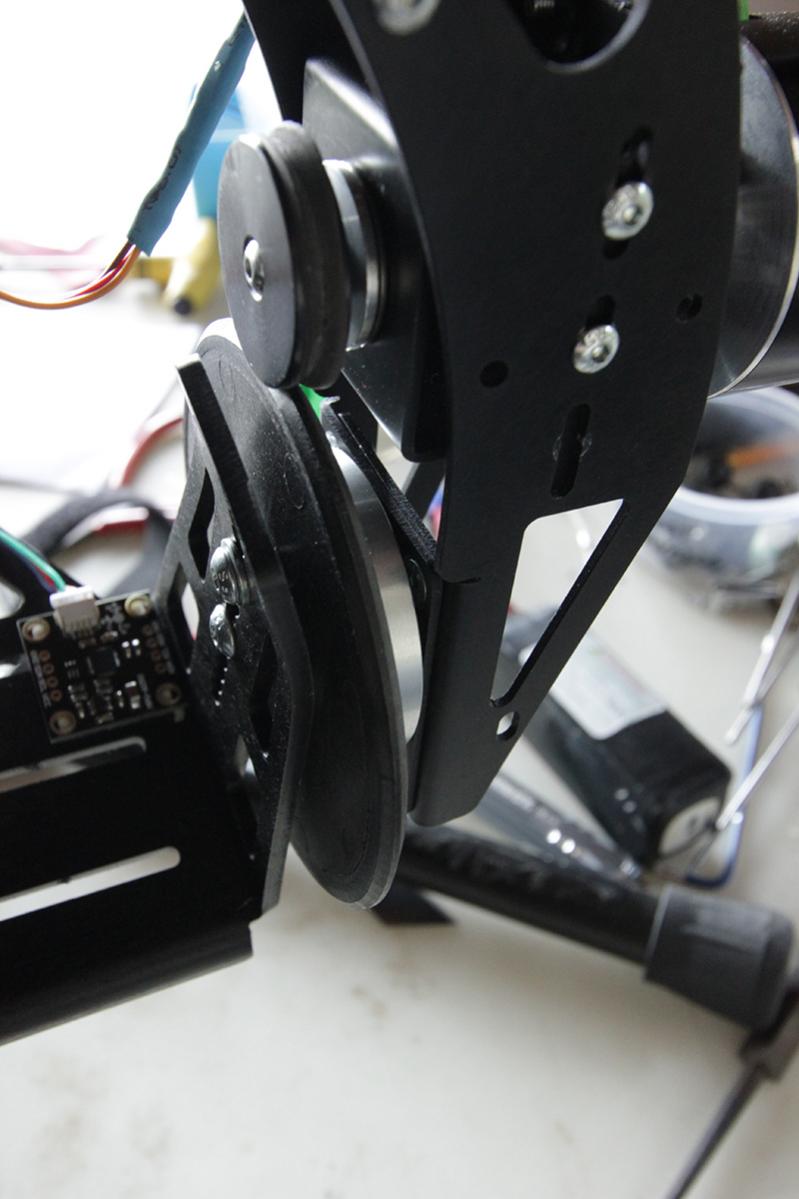

Yes all the reduction gears are the same except the tilt and roll are roller drives - we found a belt on the tilt was causing backlash and the roller drive was able to resolve that issue. With the Tiger motors I felt a need for a roller drive on the Pan axis - now I am not so certain. With the Maxons I feel there is no need for a roller drive on Pan and that the belt is quite sufficient.
Yes - the conversion is pretty straightforward if you are used to tinkering with the gimbal, I had to solder servo leads to the Maxons so they would plug easily to the Alex Moss boards. I have 2 gear trays on the gimbal one forward and one rear, the rear one fits the boards, a reciever, and has room for a downlink - the front one is for the battery.
Hope this answers your questions ?

I have the same set up..but the pitch assembly is not good..hope you are not using elastic rubber otherwise it slips?what Maxxon motors are you using...I am using Tiger GB4006
Cheers
Booma
Hi Xero
I asked Kimberly from Photohigher what Maxons they are and he said that they were manufactured specifically to PH specs - so I guess they do not have a product number sorry.
With the tilt you are right , this has been the hardest axis to tune however the roller drive has resolved all the issues we were having - there is no slippage at all and the setup is very robust with the drive shaft being supported by a bearing just next to the roller.

Will PH sell maxxon motor as part of conversion kit or as spare parts...I am an end user of AV200 but though roll has been improved pitch needs improved...
cheers
Booma
Hi Xero - yes they have the Maxons in stock and they can be ordered as part of the upgrade kit or as part of a complete gimbal.
I think the pitch is greatly improved through the roller drive - you just need to be aware that the roll axis is 10:1 gearing and the pitch is 4:1 so you need to be much more accurate with your CG on the pitch axis. I have found that when your gimbal battery is running low you can see it failing first on pitch due to the gearing.

Looks like they have mounted the RED upside down too. Wonder if that is for balance. With their "Epic" mount on the standard AV200, it hangs from the top 1/4-20s nicely.
Booma
The Epic is not mounted correctly in that pic - they need to be redone - you are correct it still hangs from the top.
