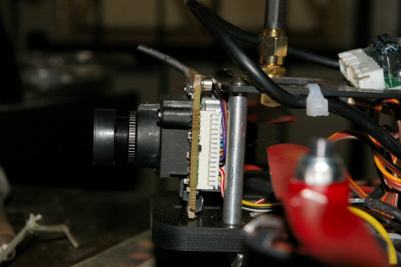

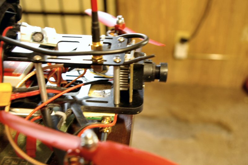

I have one of those cameras, but I mistakenly got the "board" version, no case, and no case available!
http://www.securitycamera2000.com/products/690TVL-Ultra-WDR-Pixim-SEAWOLF-Sensor-OSD-Camera-2.8mm-Wide-View-%252d-US.html
And it's larger than most, and no way to trim the board down. It has little components all the way out to the edge of the board. And, it's too big to fit between the two plates of any of the quads I have. So I had to fiddle around. I got it mounted to the stock camera mount, by screwing into the back of the heat sink, but it extends past the frame, so a head on collision will probably destroy it. The camera does seem to have a little better color quality, than a standard 600TVL Fat Shark camera. Also, it has a heat sink, which adds to the weight slightly. "BUT" $50 better than a $40 Fat Shark, "no" not in my opinion.

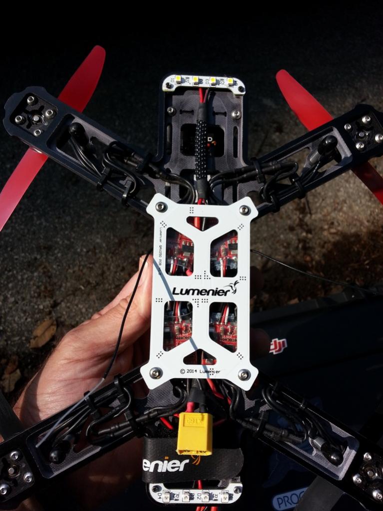

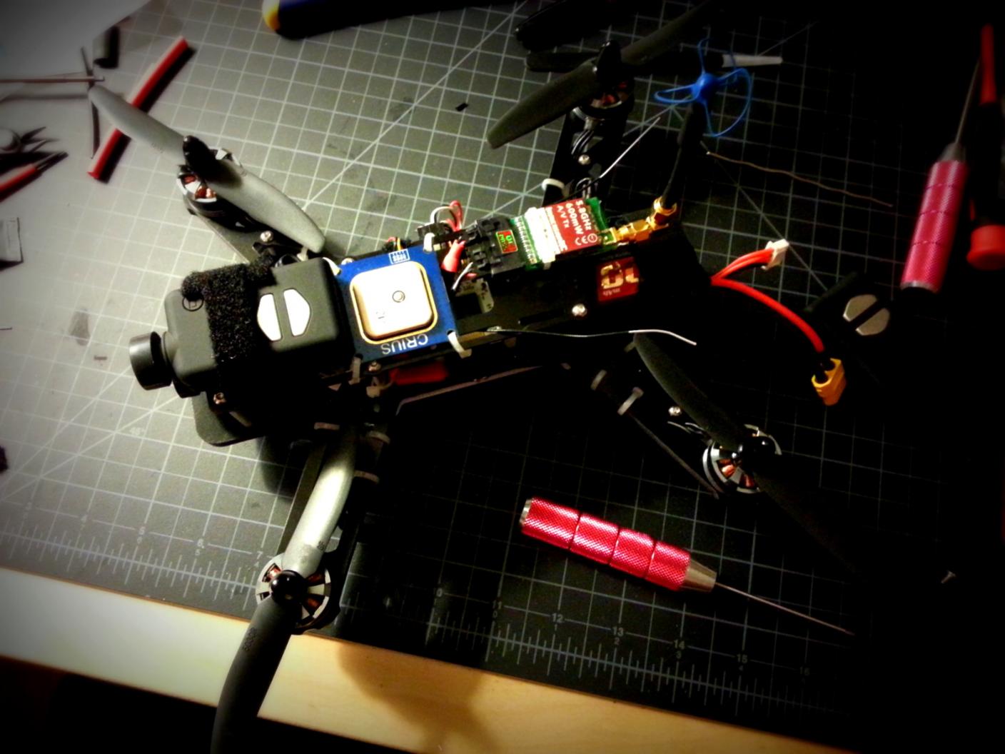

Pretty much a plain Jane QAV250 for me. FrSky X6R, Fatshark FPV, OpenPilot CC3D. It all works well together. Originally I had an OpenPilot Revo board running a ported APM, along with GPS RX on the top deck. The GPS worked fine, but I could never get the APM to fly well enough to make me want to ditch the OpenPilot. And since the GPS support is limited and rather against the mini quad ethos, went back to the CC3D with the legendary juz' settings and never looked back. Love the thing, although I have had the cajones to fly it under a car or through a drain pipe like some of you dudes :D
One thing that I wish that I would have changed, and am too busy to fix now, but that would be to run the power lead out of the side and over the top like Juz. The bottom location puts too much tension on the aft LED lead and it will break at the board eventually. I re-soldered mine 3 times before adding a "service loop". I also relocated the VTX to the top deck after frying an IRC 600mw that was mounted inside the frame with the antenna sticking through the center hole like so many do. Mine got too hot one day while tinkering and went bye bye.

Nice build chipwich. I really like the stability of my QAV250 (compared to my BO mini-h) and I've got to wonder if the single piece body has something to do with it but likely the added weight does as well. I'm highly annoyed though by the decision to use self tapping screws to secure the LED boards. I have one hole completely stripped and another on the other side where the screw snapped off leaving half of it inside the hole. Still, minor gripes for a really good frame that can stand a LOT of abuse. I've rammed mine full tilt into a concrete park bench as well as the aluminum roof over that bench (yes, I over compensated LOL) and it still flew. I suspect the use of aluminum standoffs and metal m3 button head socket screws is what makes the difference (vs. nylon hardware).
Much agreed ronin. My rear LED board is slight lose because I stripped the screws the last time driving them in. At the least, the manual needs to be revised requiring, not suggesting, the drilling of pilot holes for the buttery soft LED mounting screws.
I found a photo of the first build with Revo board and GPS. Saving them for another project.
