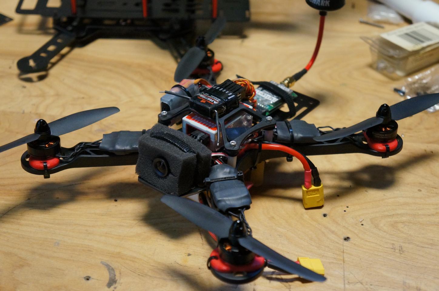

View attachment 18268 I got bit by the mini bug this last winter. Here's my FPV250 (the 9 buck hk special).
It's flying a naza v1, I've got it dialed in alright for atti but manual still gets the jitters. It packs up into a small peli case with a dx6i, uno rec. velcro'd on and a cheap 17 dollar 5" monitor from ebay. Strictly for playing, no recording of flights. I've got the cage that came out for this frame. It works great for a mobius but could never get the gopro squeezed between the props with enough room.
I'm also working on a drq250 "mini d". That'll get a kk board running stevies fw. I'm using witespys red naked 12 amp esc's (did I hear a problem?) and running rcx's. This one will also carry my gp black or mobius.
The thing I dig about these mini's is their non threatening presence, they don't scare, they fascinate. I've yet to have any onlooker say "wow that thing could take your head off!" Don't know how many times I heard that with just my 550 quad.
The biggest challenge for getting into mini's right now is finding parts. This will clear up as more manufacturer's realize the potential. I remember when I got into quads a couple of years ago you couldn't get your hands on a set of Avartos. Now you can find a set cheaper than a set of sunny's.
