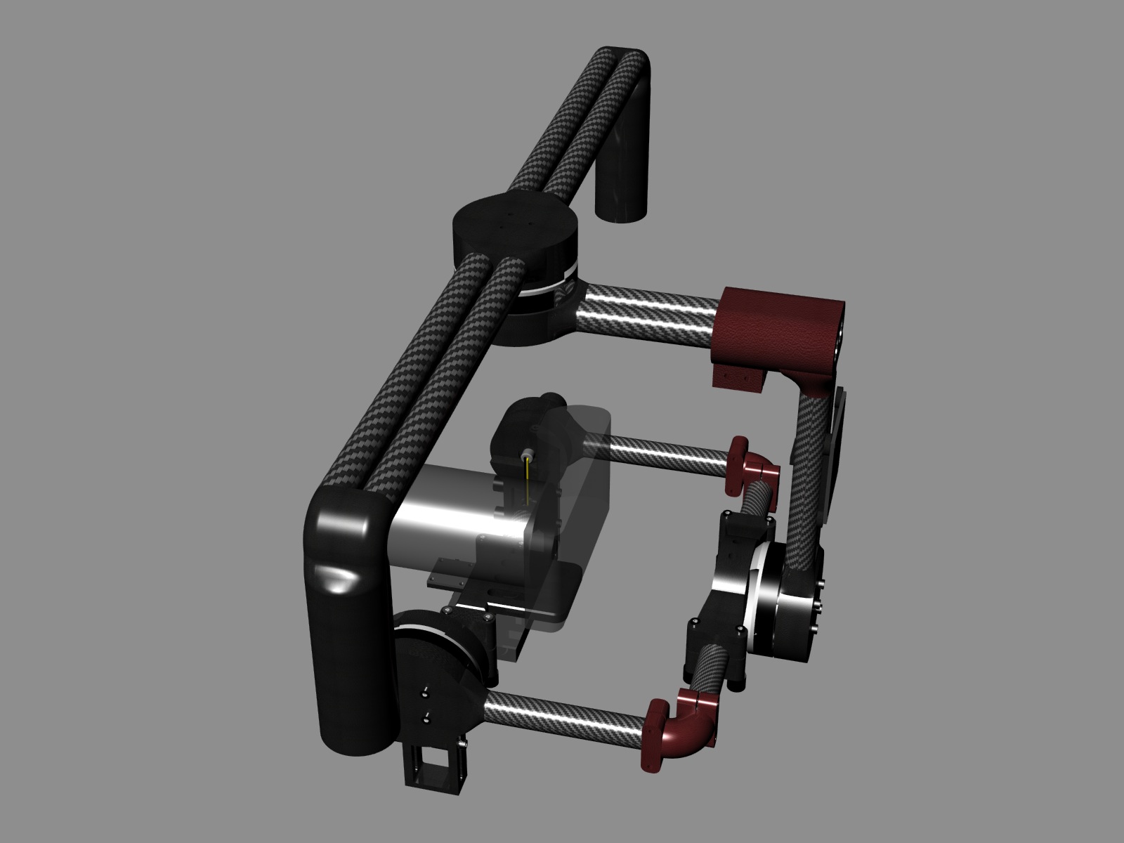

BorisS
Guys changes of the gimbal to reach the final version. To keep it more adjustable and that it can be taken apart motors changed easily i changed some parts. Not every one would like to glue the parts together like it did ! Additionally pan can be adjusted forward back which is crucial when mounting different cams to bring pan back into CG.
If any of you have any additional ideas or wishes comment please ! If i fnished up this weekend i will start posting all the STLs and additional parts needed. I hope to get the whole setup without me cutting (from shapeways) somewhere around 600 Euros inkl. everything needed !
That would be:
Motors
Driver Board
Carbon Tubes
Hollow Shaft und Bearing
3D printed parts.
Revision
Comparison

thats beautiful rig and exactly how I would like to see a mount made, Not knowing much with the brushless side of weight mainly I have not played with them much, with the way you made that is it camera specific or does it matter. I guess I ask mainly because I know weight plays i role and if that is true how would you go about adjusting for CG differences.
cheers Boris
Jhardway i had a 7d on it with a medium lense and it worked ! Its adjustable on all axis and the cam can be balanced out on tilt roll and pan. The zenmuse set the standard on balancing out the cam which other gimbals in my eyes are lacking and i took care to consider all the adjustments necessary !
Boris
iscorama
What a nice gimbal. Thanks for sharing this in future. It's really great to see when people share their genius design.
Do you use 2 alexmos boards or expansion board for 3rd axis, both boards mounted on the same mount?
Maybe you could add top handle for low angle handheld shoots?
And you could also add 3 landing gear for copter use (2 x instead handles and one landing gear on tube that will came out of pan-roll motors tube clamp)

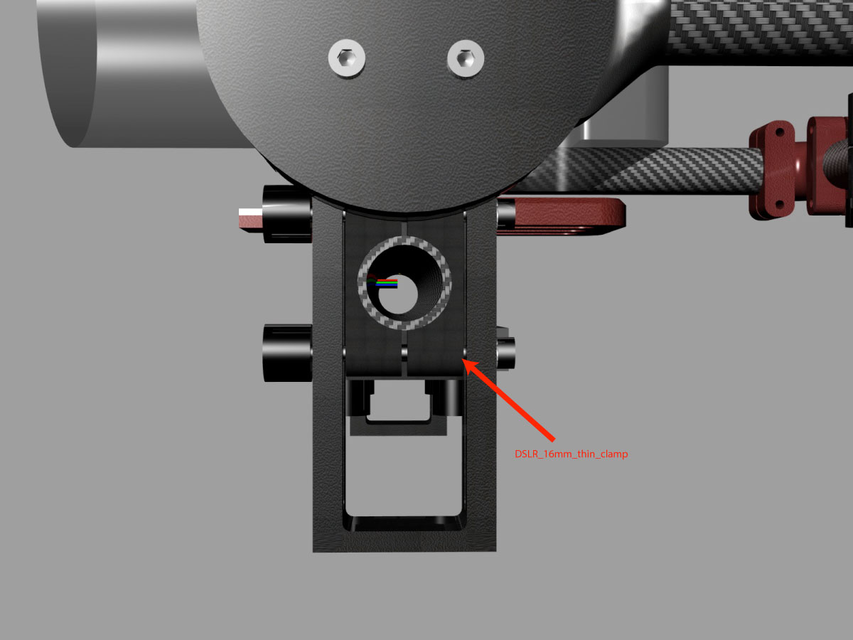

To hold the 16m carbon bar:
4x Dslr-16mm-thin-clamp http://www.shapeways.com/model/1084559/dslr-16mm-thin-clamp.html?li=productBox-search
