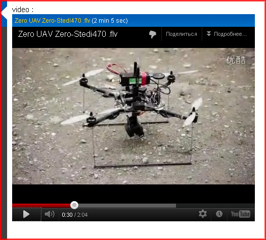

Zero UAV ZeroUAV aerial photography quad
ZAxis
ChrisViperM
That's some pretty smooth footage.....although the pilot could have made more out of it.
I like the self stabilizing feature...no servo jitter issues. Seems its worth to be investigated a little bit closer.
would putting the battery like that make vertical cg more even?
Guy is hauling butt, is all the skipping frames from post stab or my pc?

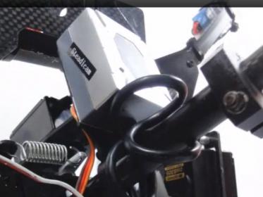

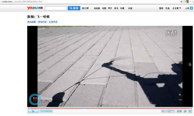

It is possible to see a shadow of the Ecilop on the
presentation of the ZERO-Stead470 :

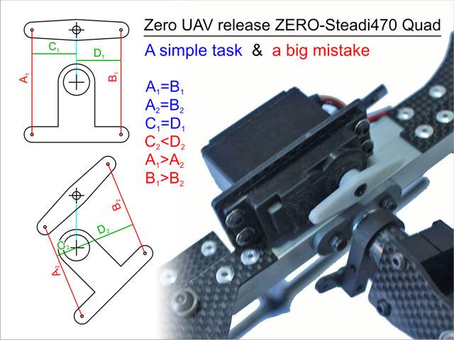

And there are some reasons for it:
That is why the gimbal of the zero can not be tilted in proper way.
There are more of mistakes.
Let's try an experimental explanation based on the Ecilop frame:
Take ECILOP Easy,
Connect the gyros to the receiver directly to get a constant input,
Place the ROLL gyro on the tiltable part of the gimbal,
Now two gyros are placed together like in a single block,
Tilt the gimbal forward 45 degree or more,
Turn on record,
Turn around with your drone to film a panorama quickly,
Roll-servo will tilt the camera sideward due to mistaken signal from the tilted gyro.
Roll-Error depends on the speed of pan-rotation when gimbal is tilted forward or backward.
That's why it's not good to use a single block on the tiltable part, like zero-guys do.
