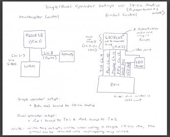

Hi Steve, OK I take back my last post, its NEARLY perfect :). Shutter, Pan, Tilt and Mode all assigned direct from the Z15 and working well on the controller, but I forgot about the retracts which I wanted on Channel 8, but I am confused how to link it up as this is part of Sbus. How are you linking up your landing gear? I must be missing something, but setting up landing gear with WKM is not very clear at all in the manual.
I think your dual receiver is a good move to future proof a 2 pilot setup, how are you getting on with this setup? I may look into the decoder for the 13th and 14th channels, not sure what to use with them yet, but could possibly be useful for roll in case of horizon issues on the gimbal.
Hi Sam
Here is a build sketch someone did online that I downloaded and kept for reference. Can't find the original post but hopefully it might help you. Just too busy to progress mine just now but maybe able to this weekend.
attachment.php

Hi Steve,
That is very interesting thank you for uploading, I think the sketch was resized on upload, so its tricky to read the text but I am a little confused on using channel 8, as being in Mode D on the Futaba 7008SB, channels 9-12 are linked to the Z15 so that should free up the first 8 channels, but WKM SBUS uses 1-7 which leaves channel 8 in limbo. For me its not the end of the world not being able to use the retracts at this stage, but it should really be easy to configure using the pilot setup I require (or so I thought)
If I am unable to find out how to use channel 8 for the retracts I will purchase a decoder and make use of the 2 digital channels.
