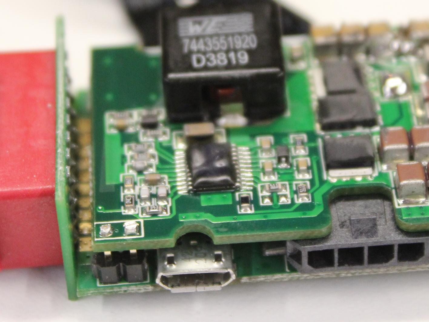

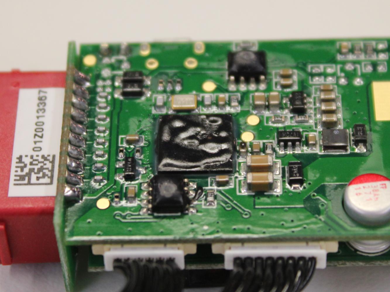

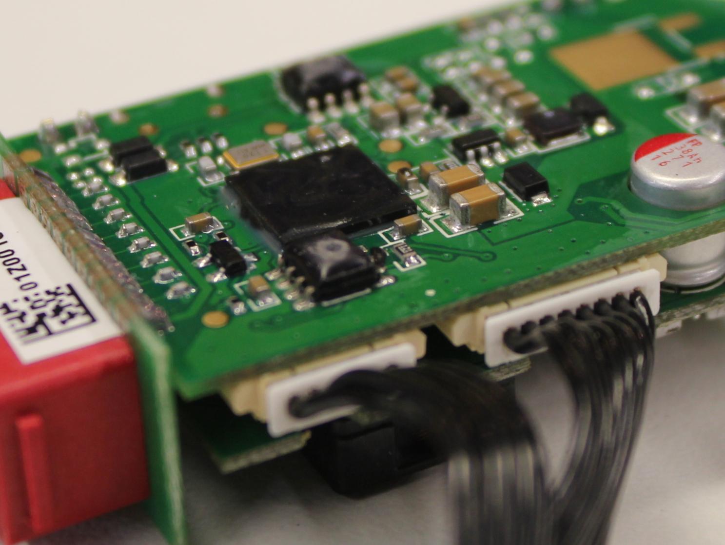

not being able to leave well enough alone I opened up the GCU to see if maybe something was floating around in there or not assembled properly. what i found was that three of the little flat black blocky looking things were actually lumpy and blistered looking. usually flat black blocky looking things are actually flat and neatly squared off at the edges but in my case they are lumpy like they overheated from within. i'll try to get some good pictures and post them here.
i'd love to find out if they're supposed to look like that or if mine have actually overheated and are now damaged. anyone else care to open up their Zenmuse GCU? you'll need a 1mm allen wrench to get the four screws out then just gently pull it apart.

pics of blistered black blocky bits

The "gunc" is there to hide what parts DJI is using, anti cloning technice.
