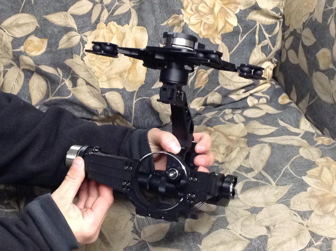

Got mine today... CAN NOT WAIT to hook it up! VERY HAPPY SHOUT OUT TO RCMADNESS for getting this for me. For those interested, I think he had one more.View attachment 15431

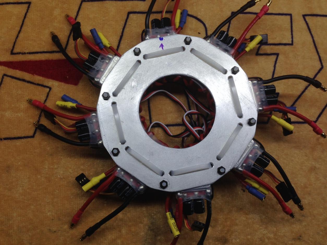

Thanks...Im swapping out the Wookong M for the A2 at the same time, so I have the Carbon Core apart as I type. Its 10 degrees outside and a blizzard in the Northeast right now, but the goal is to get this back together tomorrow. Looks like I'll be inside with plenty of time to do it...
Initial impressions...
My buddy has a Zenmuse for the Panasonic GH2, and his main complaint was the rubber vibration dampers are not in a configuration for compression, but rather extension. I see they changed that on the 5D. These squeeze together if you pull down on the camera.
The gimbal is much lighter and compact than I thought it would be. Compared to my gimbal from Brushlessgimbals.com, the Zen is much smaller and feels like its at least 1/3 lighter.
Back to work... Im so happy I don't have to "tune" this gimbal. Maybe now I can get some sleep at night...

Hey guys, we shot video last night and a couple of hours today. For starters, the gimbal is so free of friction when not powered that it is in fact easy to see that the CF card does make it off balance slightly. The lens cap makes the camera noticeably front heavy as well. We use the magic lantern firmware and sometimes shoot raw footage and the 32gb CF card is good for about 5 minutes of raw footage. To counterweight the imbalance of the heavier card, I used a dime and double sided tape on the opposite side. This perfectly compensated for the difference.
Coming from AlexMos boards and months of tuning my own gimbals for DSLR, its very important that the gimbal is balanced. This Zenmuse has adjustment screws everywhere to mover the camera up/down, fwd/back, and Im certain that they tell you not to touch any screws for fear you will make it worse instead of better. So if you want to run a filter, there is NO reason you can't. You just either need to add the same amount of weight to the back of the camera, or, move the camera a millimeter back by loosening the adjustment screws on each side. I actually had to do this on mine, because from the factory it was perfectly balanced with the lens cap ON!...but very back heavy with it off. Believe me, I was freaking out over loosening the screws that are on each side, but after literally a millimeter of adjustment, it was perfect. It took 2 minutes. It was also very easy to make the same amount of adjustment on each side, because the screws were up against the end of the slot, vs just a tiny bit away. With a filter, you'd just go the other way.
Anyway, I got over it and we filmed today and last night as I mentioned. This gimbal does require a can bus cable connection from the zenmuse gimbal control box, up to the flight controller. Fortunately, the part of the gimbal that holds the box doesn't turn. So yes, it uses slip rings and you don't have to worry. No wires to tangle.
