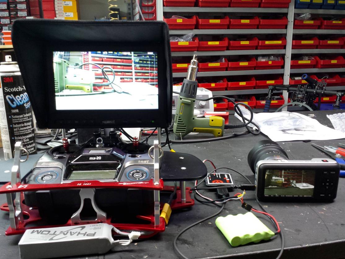

Our Zenmuse with Blackmagic Pocket was in the air today.
It works perfectly. And finally we managed to integrate a progressive
HDMI converter. I will post some photos tomorrow.
The aluminium cage is only one part. Then you have to find the COG
for the camera including HDMI cable an external converter. The converter
is powered with the HDMI out of the BM pocket. We connected the converter
with the existing video wire. So we are able to place the video TX on top of the Zen
and get the video signal out of the video out box.

For all those who sent us all emails if BlackMagic Pocket is working with Kopterworx mini Hdmi converter. Answer is yes - converter works perfectly.
