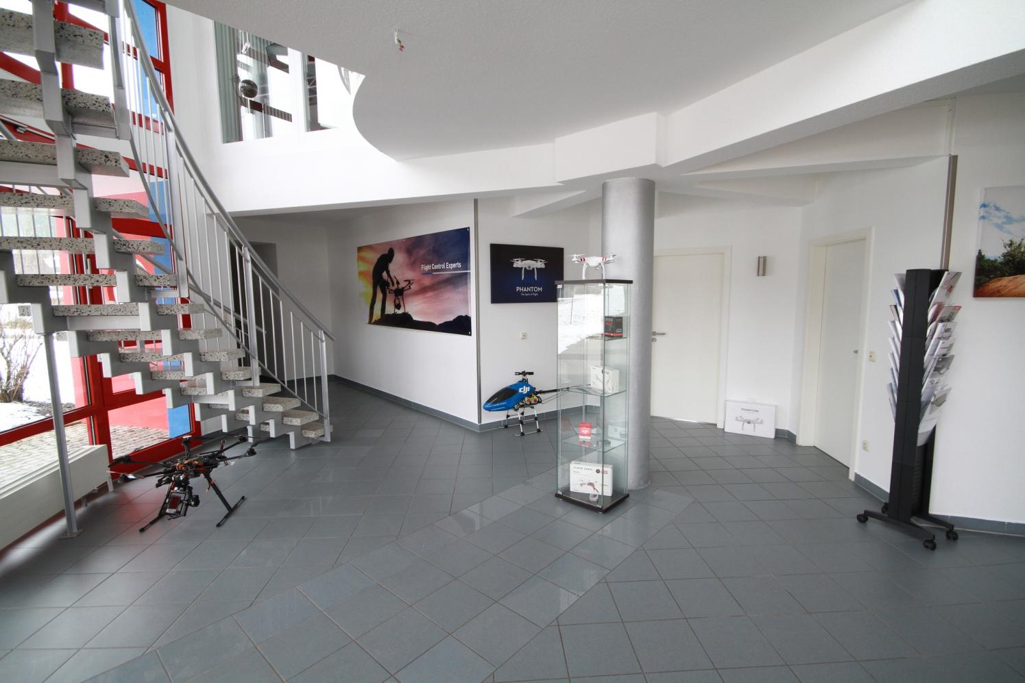

We are in the process of setting up a European office which will also includesupport, based in Germany. We started with the new office four weeks ago andhave been busy setting up the business. As you can see from the photos, this isour new reception area, not exactly an empty office!
We estimate to be operational within the next 6-8 weeks.
Any issues or repairs should still go through your dealerin the first instance.
We are looking forward to having our European office upand running and to better support our valued DJI customers.
