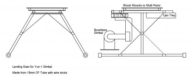

Mine is on order, I am starting to design custom landing gear.
Initial thoughts below. Once I get the Yun-1 I will figure out the balance and finalize all the dimensions. The idea is to have this be a quick mount to any MR w/o landing gear, possible including extra vibe dampening clamping system, then it would cushion hard landings as well. This should be very light and very sturdy. I have a machine shop so I will make the fittings on a CNC machine in Delrin, or possible a stronger plastic.

I find the S800 landing-skid (or a clone) pretty optimal (or a smaller version of it).
for additional damping I can recommend lambskin.

That is what I am thinking as well just smaller scale and lighter. With a quick release to the MR.
