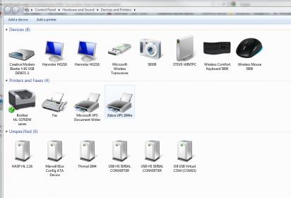

if you have windows, you should have device manager, or something that shows everything connected. on win7 it shows printers, anything hooked up externaly. Do you see a usb driver loaded and says something about dji naza? when you plug naza into your pc and fire it up, does MC Controll show green? does naza have a green light?

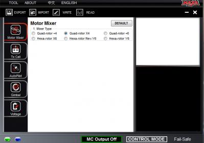

When you change something in calibrate, it is all done at the radio, the finish click is a write click to the controller and your done. when that finish button is hit and with throttle at exactly 50% they should all show green and centered, can shake a tad but is alright and when you move the stick, will all show the same movement to the endpoints
the only time you need to write is changing gains or changing the aux input assignment or changing voltage stuff. the number will show red and you have to hit WRITE to make them go black, it is slow to write, but you see it happen.

The VU led goes solid green when plugged in. The driver does show up under ports when the unit is plugged in. The Naza unit itself has a solid red light when powered on, that hasn't changed. All the other info is good to know for when I get it working past the calibration.
Green VU means it sees the pc, no driver, that flashes red usually. is the motor control off show a green box like my first attachment?
