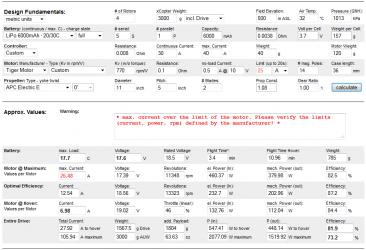

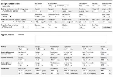

I currently have
x650 v8
Roxxy 2827-35
AKE12A ESC
2.7Kg AUW (with camera)
DJI WK-M
but I am contemplating on changing it to quad with better motor. this way the lower blades will not show on camera when its underslung.
I hope to get either
Motor: Avroto2814 / Tiger Motor MT2814 / AXI2814/22
ESC: Maytech 30 / DYS 30 (simonk firmware)
run on 5S
do you think they will efficiently run and not hot on 5S? On Ecal 4S hovers around 70 +/- so I want to go 5S. AUW might reach 3Kg. I know someone was running avroto/maytech combo but cant remember if it was on 5S.

Iris, this is not about the WKM. Sorry if its a bit confusing. My real dilemma is whether those ESC and motors can handle 5S. My WKM is working great with AKE ESC quite smoot but I want to move from X octo to quad x. There is an AKE 30A highspeed PWM but dont think it can handle 5S thats why I ask the most common ESC the guys use here.
I actually wanted to try the BL-Ctrl 2.0 tho I know someone said it will not work (well). besides my quad is a hobby quad no point going all expensive on it. Maybe if I got the money to go for CS6 :cold:
