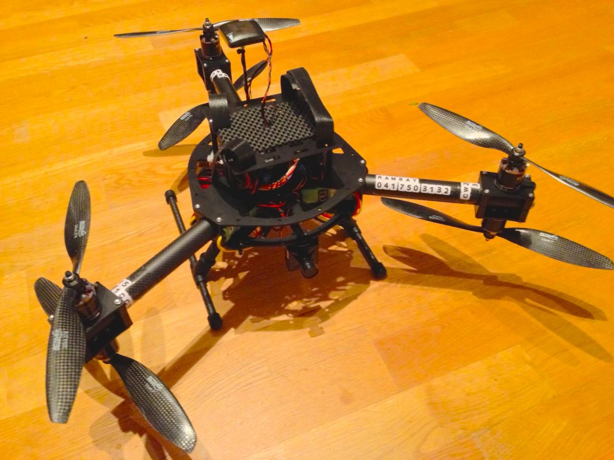

Hi all,
Just looking to see what others have for flight times with their Y6's. I am concerned about the weight of mine - 1.85kg without batteries, GoPros or gimbals. Throw on 2 x 4500mah 4S packs, and it's close to 2.7kg! It is a very solid build though - 25mm, 240mm carbon arms, and 3mm plate. My flight times - admittedly squirting at 60-85kph for the entire flight - are around 14 minutes (I get too bored doing hover flight tests). This seems low for 9000mah, and I think it's just the weight. The other problem is the 9000mah makes it really top heavy. While it doesn't seem to affect the handling, I am worried about it.
Apart from that, it does fly well, and hovers at around 40-45% throttle (according to the APM).
I have got some 4S2P 6600's coming, which will save me around 300g; I'm hoping this weight saving won't have too much penalty on flight times. Running multiple packs is a bit of a pain too, if I'm honest.
Specs:
Quadframe Y6 Pro frame, with 25mm, 240mm arms, 150mm CF legs.
APM 2.6 with GPS, minimOSD and telemetry
Spektrum AR8000 + TM1000 + Alt & Voltage sensors
6 x Multistar 30A
6 x tmotor 2216-11 (900kv)
3 x 1045 RCtimer CF props
3 x 1147 RCtimer CF props
0420 board cam, and 250mw fatshark 5.8tx
So what flight times are you guys getting, and on what weight and battery packs?
