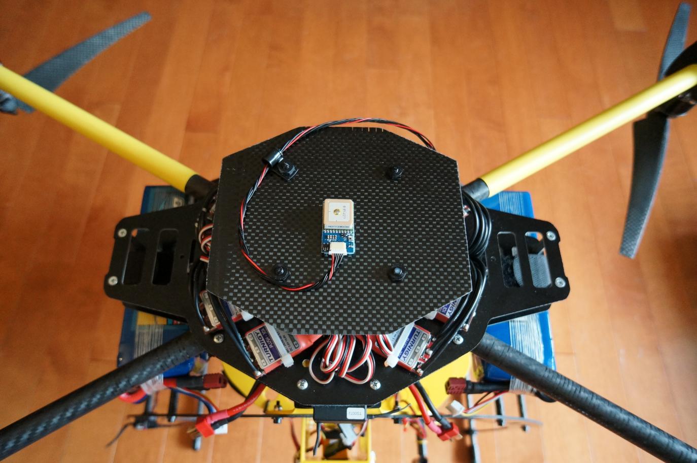

THe pics below are of the GPS/Nav board in place, and with the GPS shield I made from carbon fiber. The shield may or may not work but I wanted to give it a try as both a sun shade for the Pro board and as an RF shield for the GPS antenna. The GPS antenna masts we see a lot lately don't have much sex appeal so I wanted to try something else. There may be a ground plane benefit for the antenna but, since I really don't know what that is (where's that IBCrazy guy when you need him?), it's all pure speculation on my part!! :shame: I still have to hot-glue the antenna wire into place.
If I could just get around to finishing the plug I've been making for the dome I'd be very happy!
View attachment 4894View attachment 4893
DucktileMedia
When you use the GPS, do you need to swap all your Rx wires to that board? I always wondered about that. Whats the point in them being there otherwise?
Oh, Bart, dont forget to plug in the GPS wire to your rx! I have looked into the future. :)
no, they're there for future use. you do have to add a wire from the HF Pro board to your receiver to control the GPS functions. thanks for the reminder.....doh!

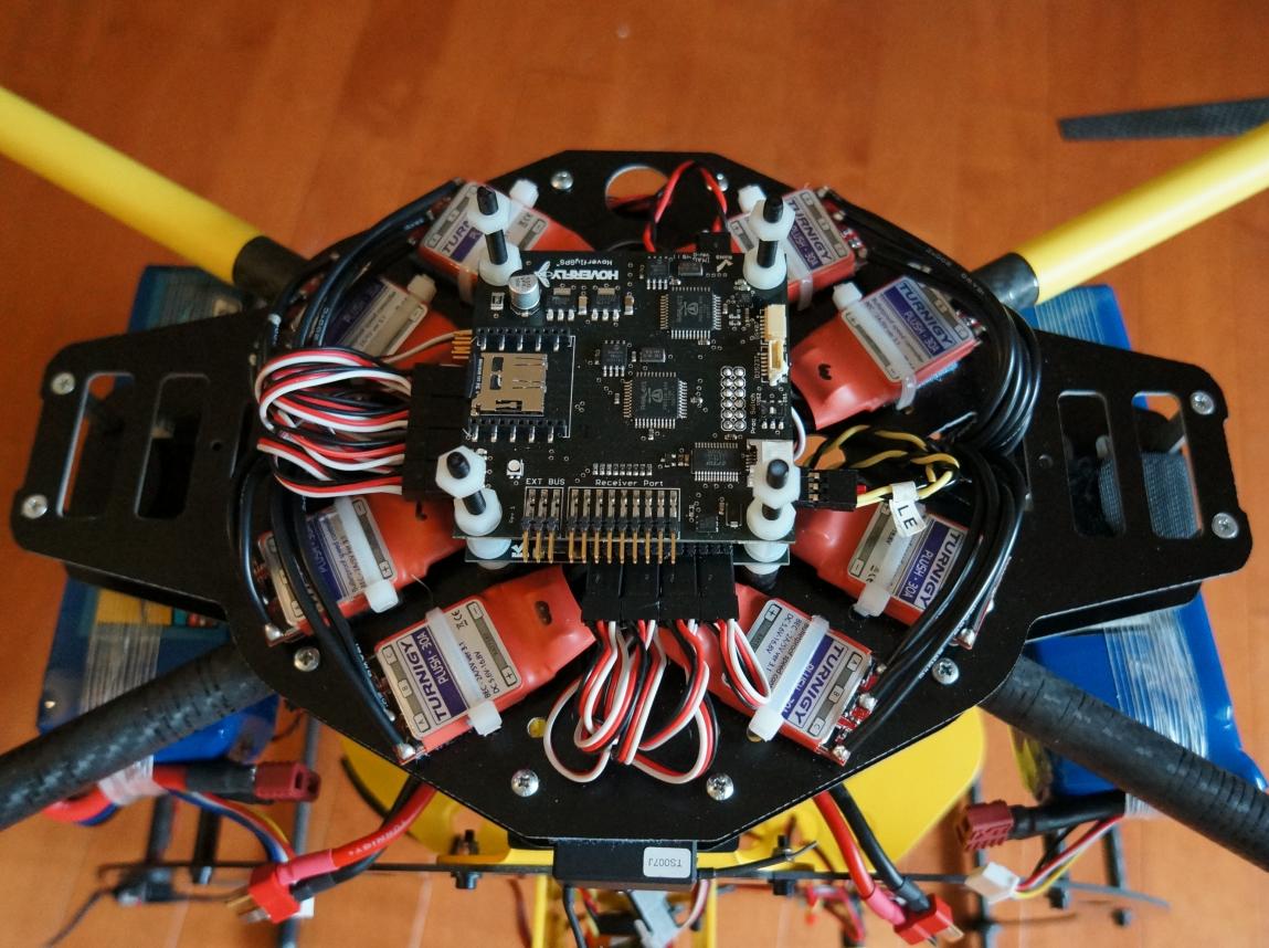

here are a couple of more photos, the first is an arm assembly with the wires routed and LED's installed. only the two front arms will get the LED's and yellow heat shrink. i use red LED's as they seem to contrast the best with a blue sky. i've also tried blue LED's but they just about disappeared with the blue sky above them.
the second photo shows the top of the frame with the ESC's and Hoverfly Pro board installed. i may or may not have time to continue tomorrow but all that is left to do is to double check the firmware is the latest version, go through the setup client to make sure everything is indicating correctly, and install a receiver with a satellite or two plugged in.
