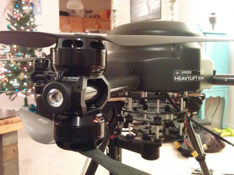

it only takes a small piece of the lead tape to balance the prop hub. i had been using aluminum tape from an HVAC supplier but even that got a little bulky, the lead tape is easy to cut with scissors and sticks well enough to be used on the prop. they make it for weighting golf clubs so it's pretty sticky.
