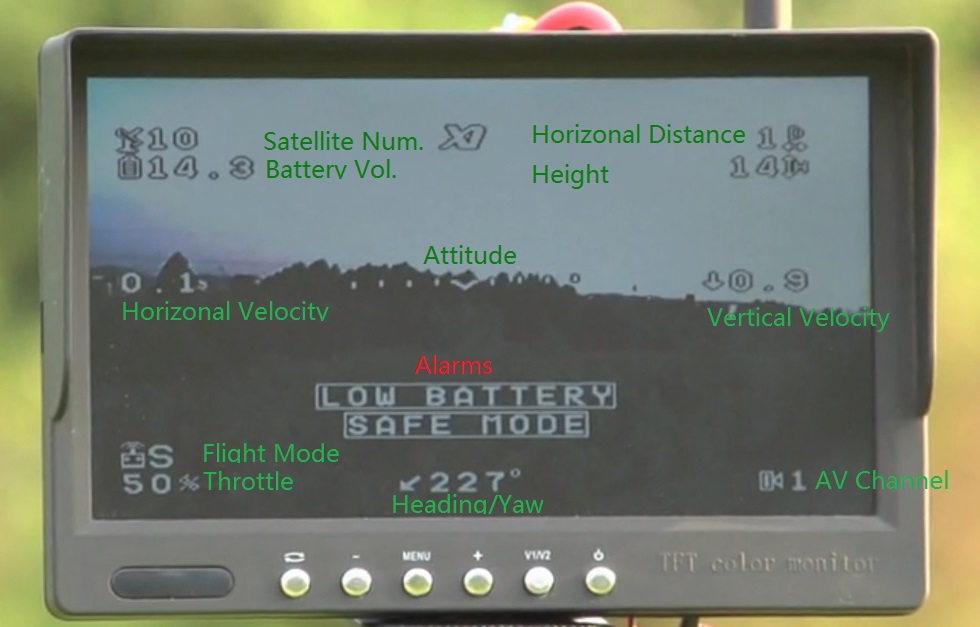

Is it bigger than seen here?
X650Mouse
Take no prisoners
That's it.....That's what mine looks like, in the goggles AND on the monitor.
Phew! from your description I thought it was a big mask like thing in the centre of the screen :shame: I can live with the little logo, my OSD arrives tomorrow

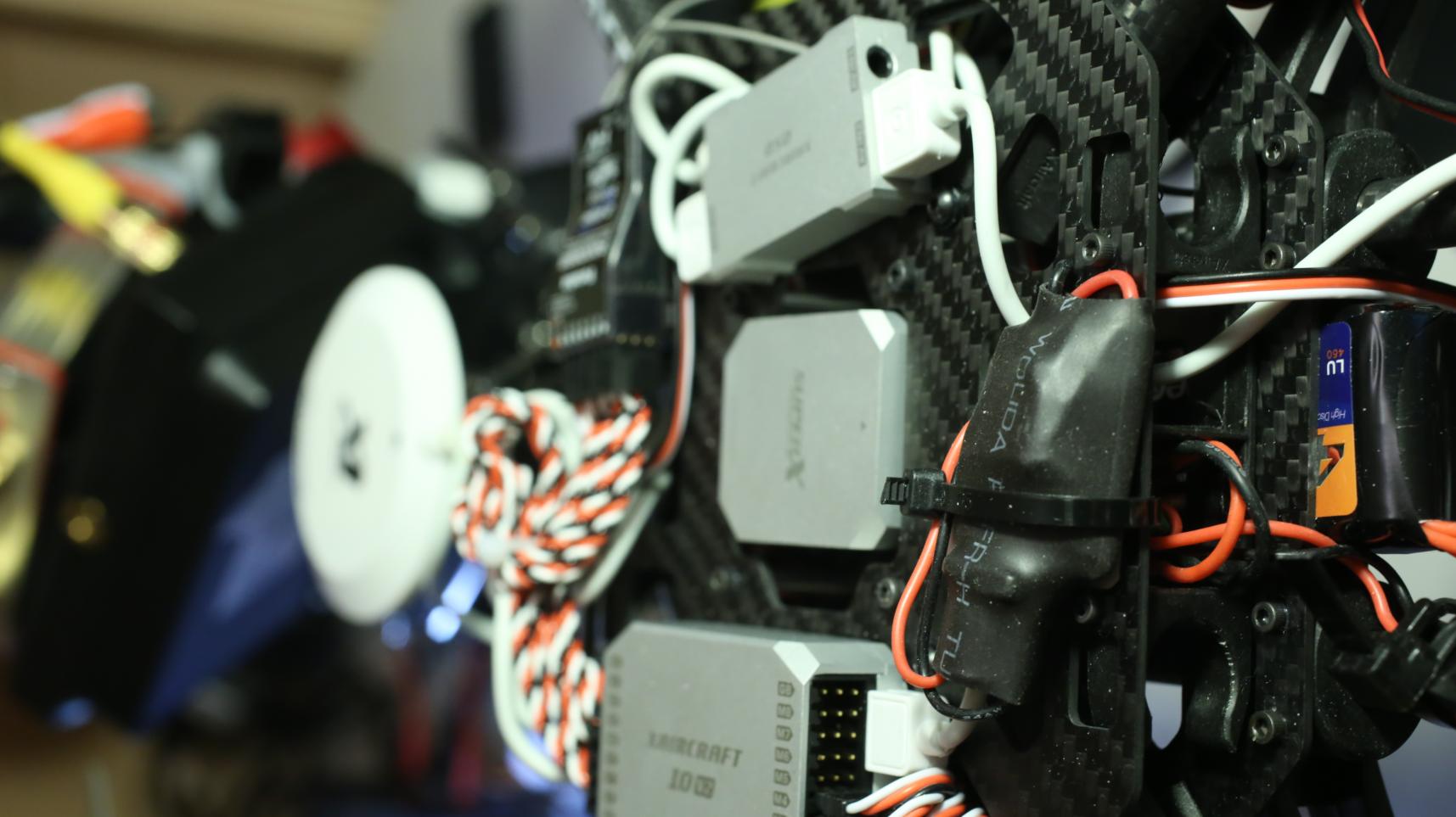

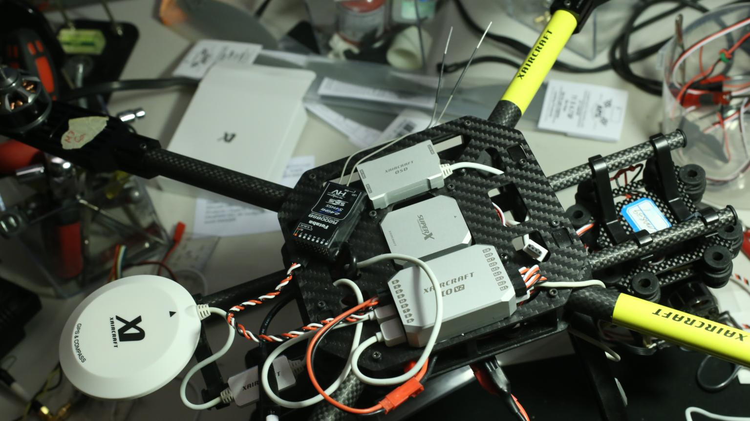

This is mine I am normally very fastidious about where things go but the OSD wound up on the IO it just seemed there was a nut everywhere I wanted to put it.
Just purchased the Arris CM3000 too! so big day

Thanks for the pics, guys. I didn't realize the OSD unit was so big.....it is hard to tell the size in the store pictures.
Also, your set-ups each have UBECs......are these supplying power to the SuperX or to the Rx or both? I haven't decided on whether to use one or not.
X650Mouse
Take no prisoners
My UBEC is to supply power to the Gimbal, SX doesn't require a UBEC it has it's own.
Be sure to power your SuperX directly from your flight battery, especially if using the OSD. If you feed it from the UBEC or an external battery you will not get an accurate voltage reading and it will cause issues. The OSD is a must have in my opinion if you are serious about filming or flying FPV. It gives you the info you need in an easy to read format and makes flying while watching a live view from a gimbal doable due to the attitude indicator and vertical/horizontal speed indicators. It really makes a world of difference. Without it it is very hard to tell how you are leaning at any given time, how fast you are descending or ascending, and how far away from home/high you are.

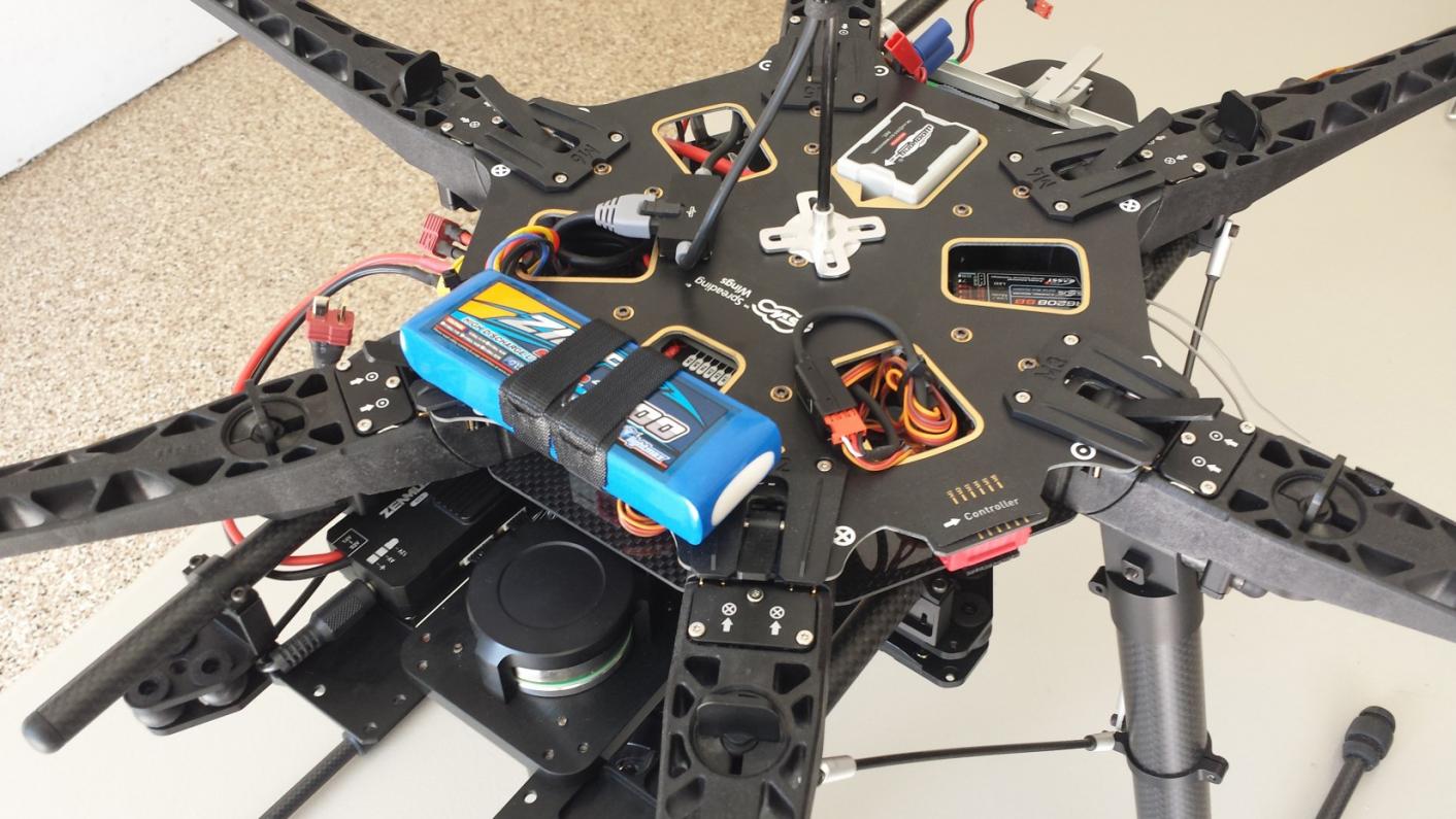

Yes i love the osd it 's better than dji mini osd i use the bec to run the gimbal the tx immerce i can straight plug to 14 volt but for now i have extra small battery to run it just want to see if i get less noise since it not from the main battery. View attachment 18857View attachment 18858View attachment 18859View attachment 18860View attachment 18861
If you are having issues with noise put a ferrite ring on the power supply. It will clean it up nicely. It is much better to run constant voltage from a UBEC than to run variable voltage from a lipo for the gimbal.
