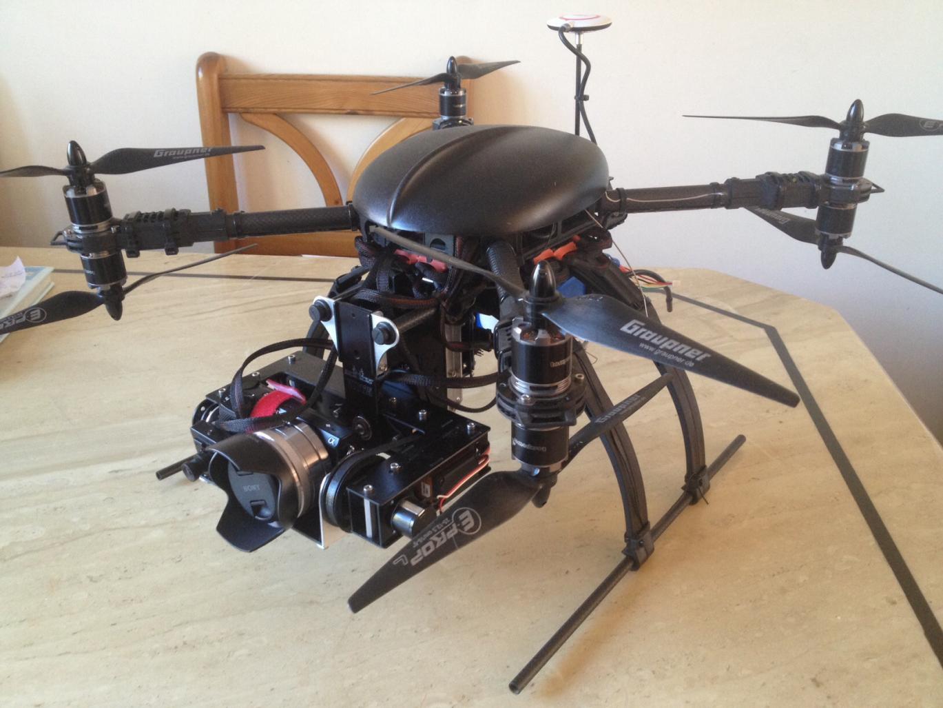

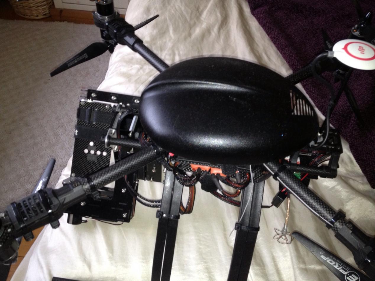

View attachment 15319View attachment 15320The v8 conversion to Naza was not the easiest for me (in fact I went Wookong). The xa ESCs were not compatible with my WKM, hence I needed to replace the ESCs and I replaced the motors too. The problem with ESCs over 10amps is that they won't fit in the arm. For this reason, I had to build a second floor on the X650 to accommodate the replacement 30amp ESCs (8 of them) which connected to a central power distribution board within the centre of the 650.
I used Torxpower 2216 motors and will include images to see the setup.
The work was expensive but worth it, as I now carry a sony Nex 5r and full downlink with ease. It flies an absolute dream

It was predominantly down to payload and reliability. The Torxpowers are around £30 each, hence the cost of replacing eight motors and ESCs was a big decision. I use a 4s 5000mah battery which gives a safe 7 minutes (fully loaded).. I have a number of multi rotors and this beastie is ridiculously stable and really powerful
