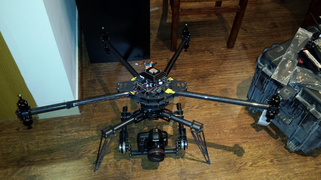

Salvaged parts, new parts, trying some new ideas.
Aggressive Boom placement. This was an aesthetical choice, I will see how it handles.
3D Printed/Wire Vibration Isolation between MR and Gimbal.
3-Axis gimbal with the large 8100 series motors on the pan and roll, dual 5106's on the tilt.
