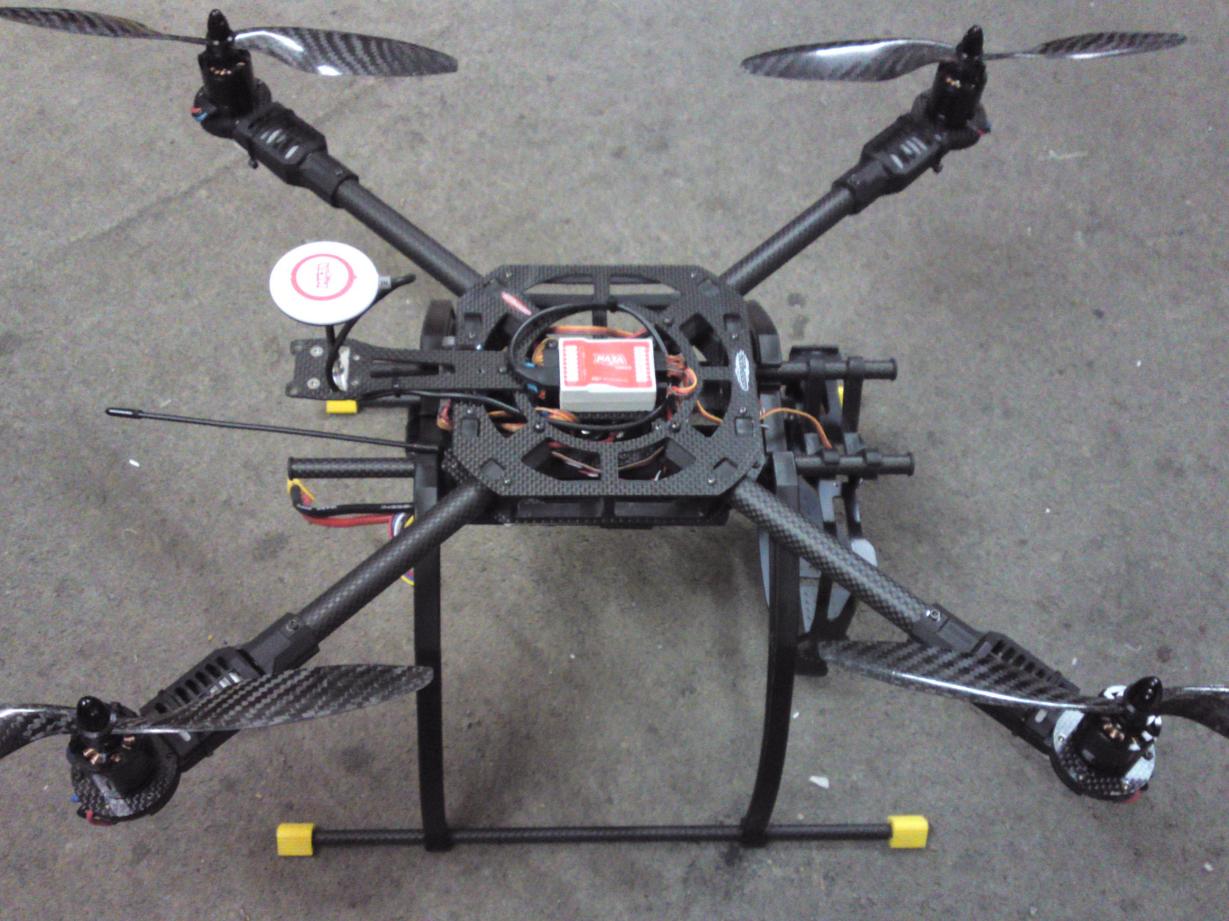

i was using the setup you mentioned earlier... but decided to upgrade the motors(dunno really if you it is) to sunnysky 2216-800. you'll need servo extension on 2 front esc's though...

Looks good. I take it you mount the ESC under the arm and cable tie it on? Also, where did you get the carbon arm to mount the GPS on? Does it come with the X650 kit?
fayrwerks
just crashed it...:C but anyways un mount the esc with a cable tie... the gps mount is a top deck for HPI touring car. if you can purchase a pair of X-aircraft load mount (battery mount) even better since you can easily remove the GPS when transportin the quad.

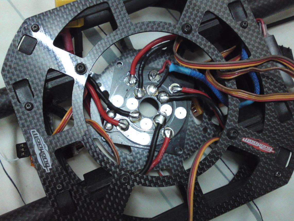

3. 2 servo extensions (if you can see on my second pictures) servo leads from ESC 1 and 2 goes directly from the boom to the front of the NAZA MC. the leads for ESC# 3 and 4 has to go all the way around the MC.
4. yes
5. some spares (motor mounts, arms, landing gear skids...) this quad dont take hits as tough as DJI Flamewheels -
6. might wanna also purchase a distribution board... makes soldering easier...

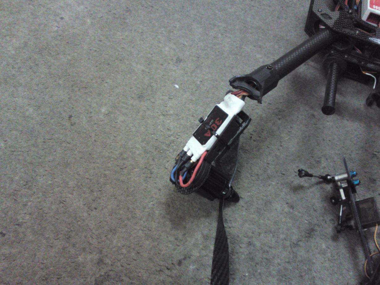

Almost ready to buy. Just a thought about ESC lead length for the DJI ESCs - how did you make the +ve and -ve wires longer? Mine are short so not sure they will be long enough to reach a power board mounted inside the X650.
Or did you solder on connectors to the ESCs to provide power to them?
fayrwerks
all my esc leads are of stock(dji) length... did you cut your leads before? i guess if you cut it its best to desolder it from the esc's and solder a NEW longer leads. same for my +ve/-ve they were stock lengths...
Totality
Strange. I have a F450 and the ESC +ve and -ve leads are only about 5cm long. The ESCs mount under the arm and are soldered to the board so only require a few CMs. Maybe you had a F550 so ESC leads were longer? I haven't cut anything, but the stock lead length is short.
If you look at the image here you will see what I mean. If I mounted these ESCs under the motor where the originals go, there is no way the power would reach the inside of the X650?
