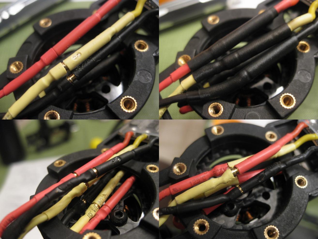

I disassembled the boom last night, checked all connections, heat-shrinked the connections to the motors (there was a good bit of chaffing happening on the wiring). After taking care of this everything seems like it's working okay. Will report back if the issue continues. I wish they would have made the area where the wiring runs under the motor just a tad larger. I may add some spacers/washers under the mounting plates to give them some breathing room. The wiring is also getting pinched from the motor screws on the underside of the plate.
RyanArch
Here's a good reason why you should protect your wiring under the motors with heat shrink. Mine were pretty pinched and rubbed (by the mounting screws and the bottom pin of the motor). I'm gonna try putting some #6 nylon washers (they're 1/16" thick) in between the arm mount and the mounting plates to see if that gives enough breathing room to try and avoid the tight quarters in there...should amount to about 1/8" more clearance on the underside. Will test over the next day or so.
Let me know if this is a terrible idea :)
