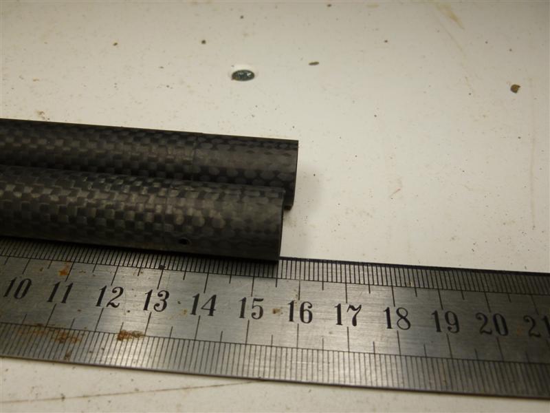

XAUSA a question for you...I have found my standard XA motor booms are different lengths almost 1/8th inch, is this a problem? Could it cause the fault as described before? Thanks JohnView attachment 1421

XAUSA a question for you...I have found my standard XA motor booms are different lengths almost 1/8th inch, is this a problem? Could it cause the fault as described before? Thanks JohnView attachment 2397
I see one end on the ruler, but you should check the distance between holes, cannot speculate on what I am seeing in the photo. The length of the booms should be constant but if they aren't the holes should be.
Yes it very well could, due to ESC overheating over a few minutes. Are these the "BOOMS", that came with kit or are 1 or more replacement "BOOMS" ?? Boom manufacturers we changed recently because of manufacturing delays. I suspect this is where and how the issue was born.
Important- Only drill new holes in "CF BOOMS" in a controlled enviroment, Carbon Fiber is extremely dangerous to breath. You must wear. Gloves, Breathing mask and protect your entire body. Then clean all areas with damp cloth as not to recreate dust from the work areas, you should work somewhere other than your native work desk or your home. TAKE these outside and redrill if that is your intention. PLEASE Email: biz@xaircraft.com ... They will send you a round of matching booms << But if you need booms prior to this .. PLEASE pay attention to my directive as far as working with carbon fiber materials. Best of Luck, I would try to supply these but the direct factory link would be better and make them aware of the situation from a customers stand point. I will also speak to them about this. We will fix you problem the fastest way possible.
I apologise for your situation and do not know how this type of error slipped through, the XAircraft team are very diligent about quality control.

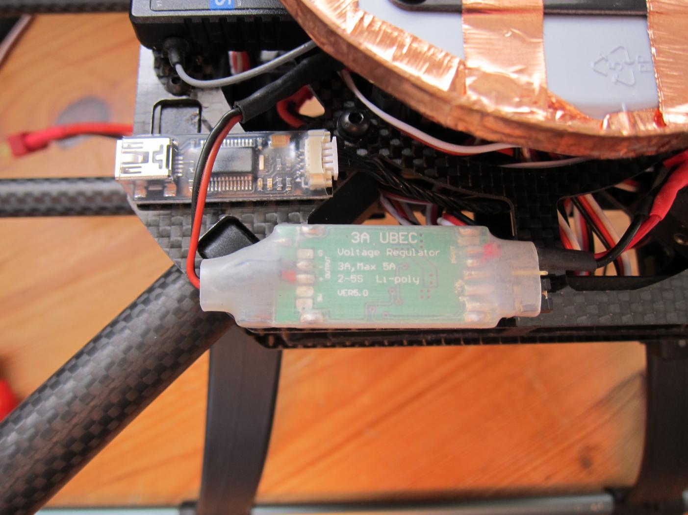

One thing i did not think about when building is that all my ESC's have the BEC set up. I will try disconnecting the on board BEC's and use an external switching BEC. This should help keep the temp down on the ESC's and give me some more battery time. Dose any one know if the x650 v8 can handle a 4s lipo and at what voltage the FC runs at.

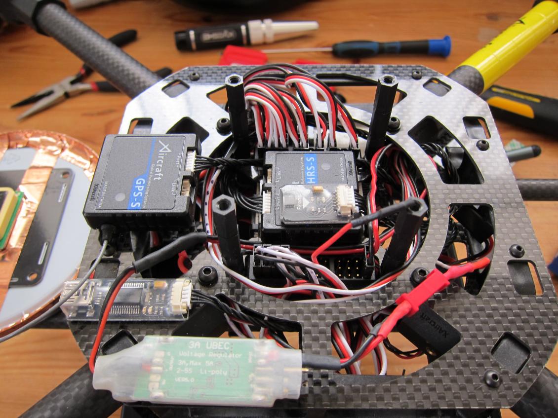

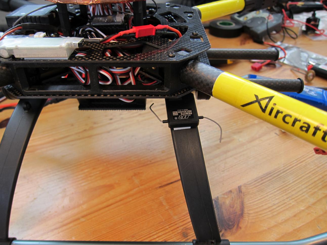

My bird has the tendency to drift to the rear and left. I'm flying the V-8. Today, I tried to lift off and it kept flipping over. Did this about 5 times. Recalibrated the AHRS and RC and tried again and it took off ok. This isn't the first time I have had to do this. Still have the drift to the rear and left. Re-terminated all motor leads and let the unit orientate to the outside weather for 5 minutes prior to powering up. Bottom left motor doesn't spool up as quick as the others. If this motor is underpowered, I could see where it would drift to the rear and left. Going to switch motor with one from the other side and see if trouble follows. Might even take off all four bottom motors and start from there.
