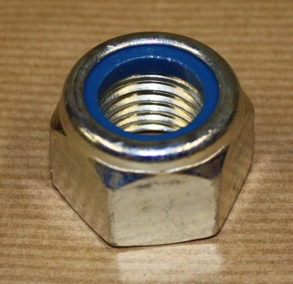

PS. Do other people use nyloc nuts on their props?

Nice post! I think we could all benefit from lock nuts on our prop adapters. Its something than in hindsight should probably be included with all motors from their manufacturer.
