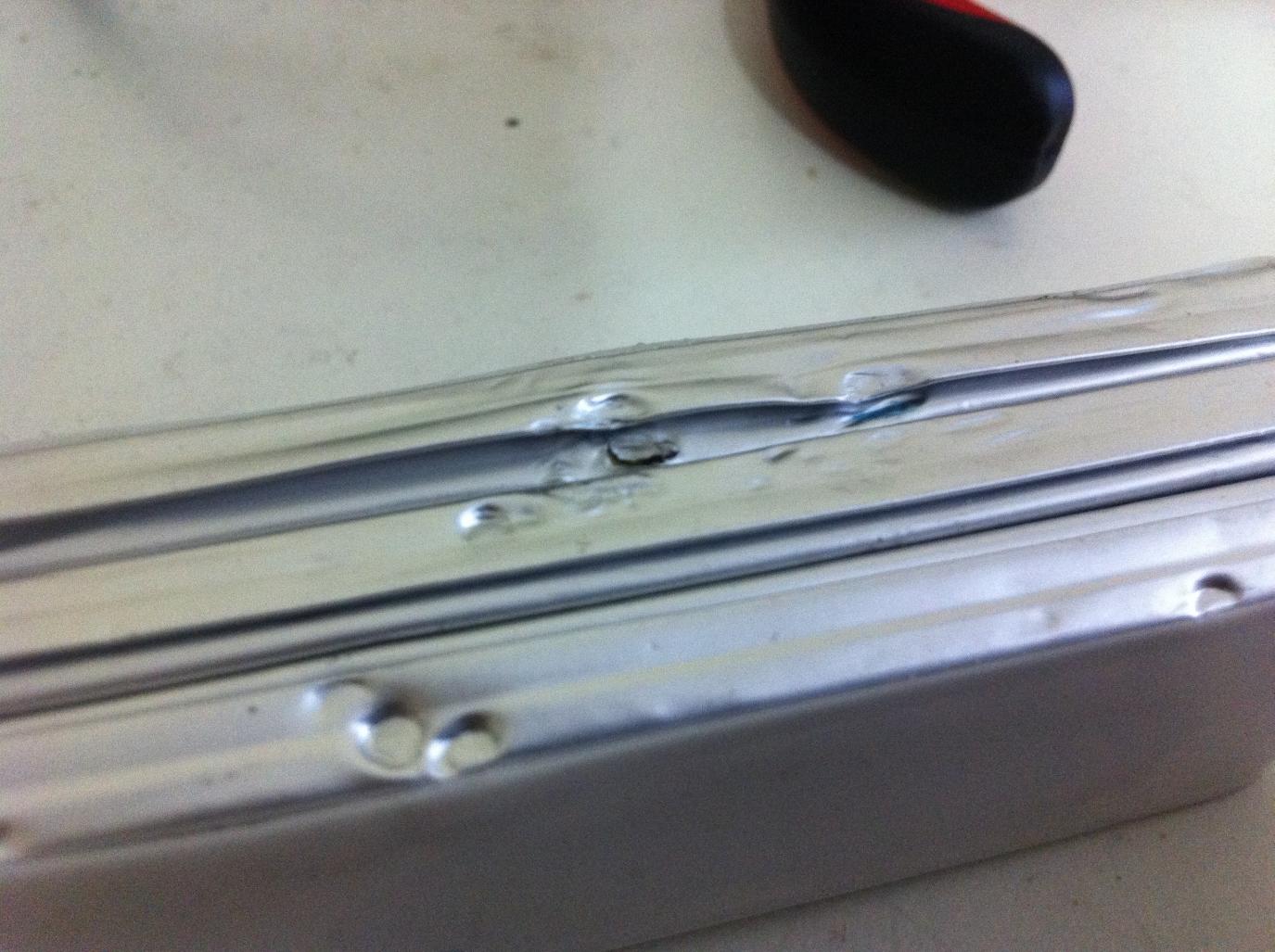

Several weeks ago I crashed my CC bird. Since that time, I didn't check the Lipo on it. I checked it today and it had an impact when crashed.
I'm not sure to use it or not.
Here are some pics:
View attachment 875View attachment 876
Would you use it?
That's Turnigy 3S 2200 mAh (20-30C)

Easy - Remove the connectors and drop into a container of salty water outside... and ignore for a week.
Step 2 - drop in bin
In case you are not sure how to dispose of it... :)
Pete
Efliernz
Pete
The remaining charge discharges into the salty water. It also nuetralizes the lipo chemical composition so it is safe to dispose it in house-hold rubbish.
Thankfully after 6 years of lipos I have only done this to five packs. Not bad since I fly daily!
