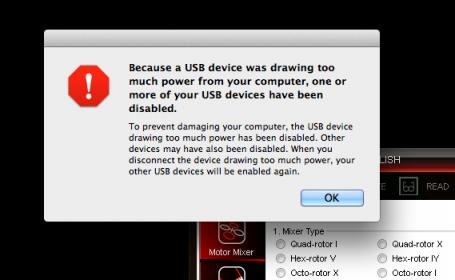

I purchased the unit from Robert at DJI USA. I installed everything as per the instructions, installed the 32-bit driver and assistant software, and have tried on 3 different computers (an Imac and macbook pro using fusion+Windows7, and a PC using Windows vista). I've removed red wire from the ESC's. When I power on the Wookong it has a solid blue light on the MC. the LED cycles through some colours then nothing. Then, first time I plugged the USB cable, my IMac literally turned off The cable felt hot. Then I tried again, and I had an error saying a USB device was drawing too much power and has been disabled (screenshot attached). Meanwhile the software asks me to login, but then has no connection and the read /write buttons are greyed out.
