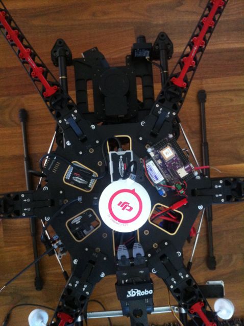

View attachment 12295The altitude offset is just visual. And as you've noticed, it's confusing when used in simulate. It's because you're measuring an altitude from where ever your unit is sitting when you're using GCS. Don't worry, it works perfectly when you're actually at your site. If you're having trouble with the one key takeoff, I suspect it may have to do with your compass calibration and COG. If these are off, nothing works autonomously. My unit used to go crazy when I'd flip the return home switch and it was nothing more than turning my compass puck to the right until it flew strait in GPS mode. When that was fixed the return home worked flawless. The same thing with GCS, the s800 now flew perfect grids in multi waypoint. Calibrate and get it flying strait in GPS. Then make sure the return home works perfect. Then try your auto takeoff, you should be good to go. And keep practicing in sim mode, it's a great way to get comfortable with GCS. I included a picture of just how far the GPS has to be rotated just to get my unit to fly strait. BTW, 140% distributed gains made a world of difference in flight accuracy using GCS.

It just goes up about 15 feet and then waits. Don't freak when you see the red light, that's just means it's ascending. You would think it would ask if you're sure about taking off lol! Funny thing is that's what it does when you click go home which I find pointless. Why else would have I clicked it lol! Don't forget to put your stick a mid position as it will still take off. You wouldn't want to click into manual at low throttle position if you had to. And no about all the gains. The distributed gain is in the advanced section (I think that's what it's called, not in GCS right now). My actual gains are 220 220 160 180 and attitude 200 200, but that's for a really heaving S800 full load camera rig.
