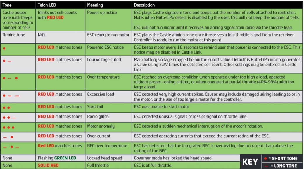

-After I land it, I can hear the motor beeping quickly for a minute or so and then stops, after which I can't arm it with the others.
Sounds to me like a temperature warning or maybe an over current warning. Not sure.. check the manual. That's at least how the warnings work with my castles. Different patterns of beeping for different parameters.

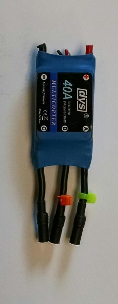

@fltundra - are these the ESCs he has?
I would say that the ESCs you have need to be matched to the motor amp draw - so if the specs show under 40A (by a safe margin), you should be fine with the size you have.
ESCs can be bad. Numerous reasons. Definitely test the ESC the way you did the motor to see if the issue follows the ESC.
ANX james
ESC pic attached. ...I don't think the codes in fltundra's chart would help diagnose accurately, but perhaps they're similar.
My motors are supposed to draw 30A max continuous... right now all of my ESCs are identical, but I'm beginning to doubt their quality. If I switch one at a time (or 4, perhaps) will it mess me up?
