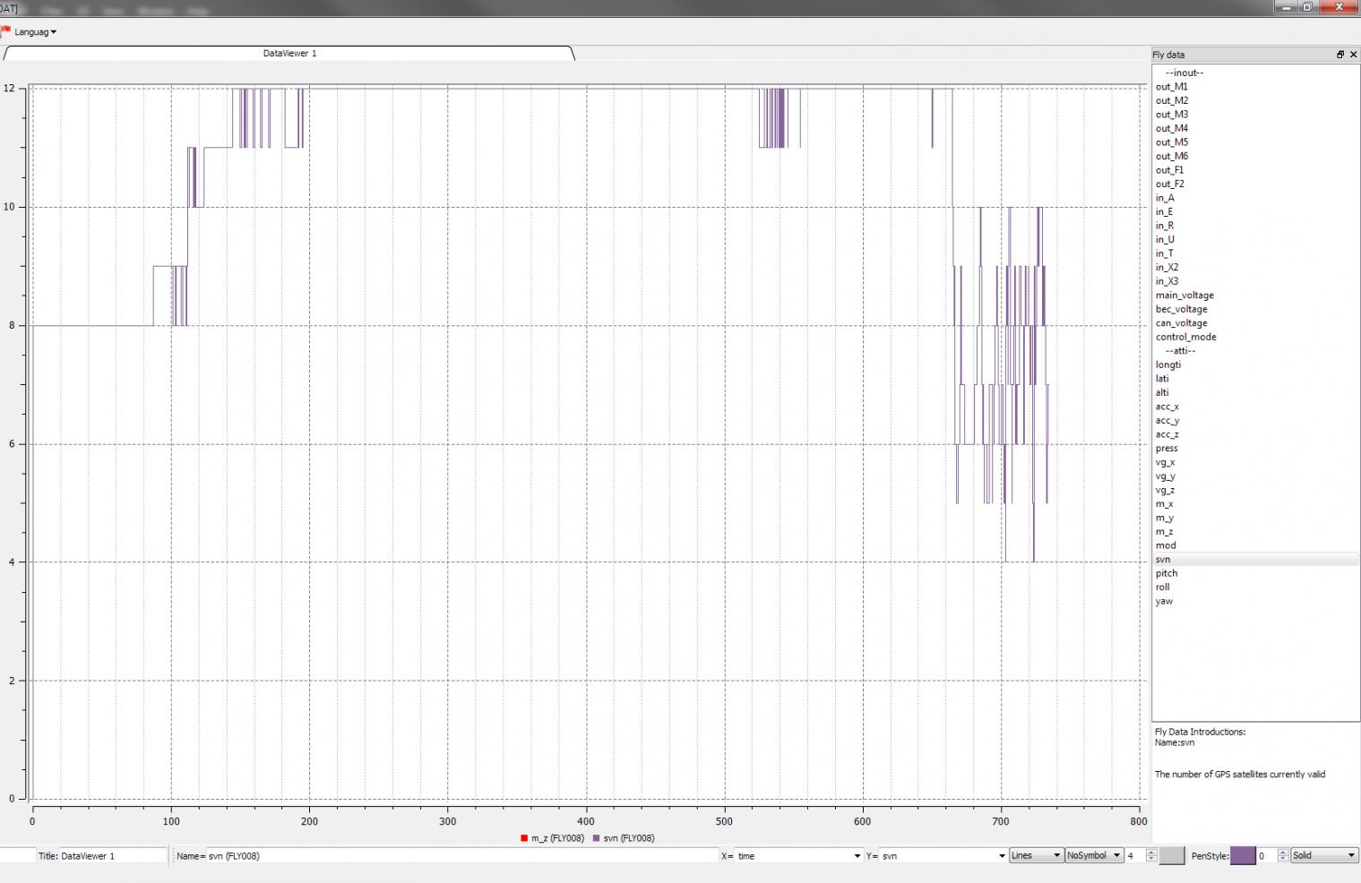

Take a look at my Z Compass Data and Satellite, maybe you can tell me what would make that happen. If you want all the data, PM me and I'll offer it up for your evaluation. Look at how crazy SAT validity is 10-5-10-5-10-5-10, etc....
View attachment 18177View attachment 18178
View attachment 22368View attachment 22369

I don't have a WKM but I know the NAZA will exit advanced features when it goes below 6 satellites.....so I wonder if the WKM is the same and if the erratic flying you observed was the heli losing and quickly regaining satellites making it repeatedly enter and exit whatever mode you were flying in.....regarding FAILSAFE, it will only work if it has the satellites to stay in that mode.
so, consider it was experiencing loss of its sixth satellite, it would drop from an advanced mode like IOC but shouldn't have lost GPS Mode (essentially position hold), if it choked on the GPS feed and lost all six then it would drop from GPS Mode and be unable to rescue itself with FAILSAFE. But if it choked on the GPS signals, cleared itself and then repeatedly choked and recovered, it might appear as a crazy a$$ dance in the sky helped by your desperate attempts to see some form of control response.
Plausible?
Plausible?
I read that WKM is setup to do this as well but i noticed no difference in flight performance if it did happen. The iOSD data shows that it switched to ATTI 3 times during the flight, once almost immediately after takeoff which perplexes me. Then twice very very briefly during the meltdown. The data also shows it flipping into Waypoint Mode near the end whatever that is. I don't have the downlink to utilize the waypoints so I think that's just where it went craziest.
The auto switch to ATTI in the beginning of the doesn't align with any of the other recorded flight data so I'm not for certain its trustworthy. Your choking and recovering theory sounds reasonable for sure. I shoudl see more rapid changes in the data from GPS to ATTI too and it's just not there.
Anything is plausible Bartman. I can only say it's dance seemed consistent with itself and not necesarily impacted by my inputs as well but it's very hard to say. It's altitude increase, fighting against me as I'm trying to bringing throttle down too was a weird one. I only killed throttle completely after the aircraft was gone (down) and far beyond recoverable.
