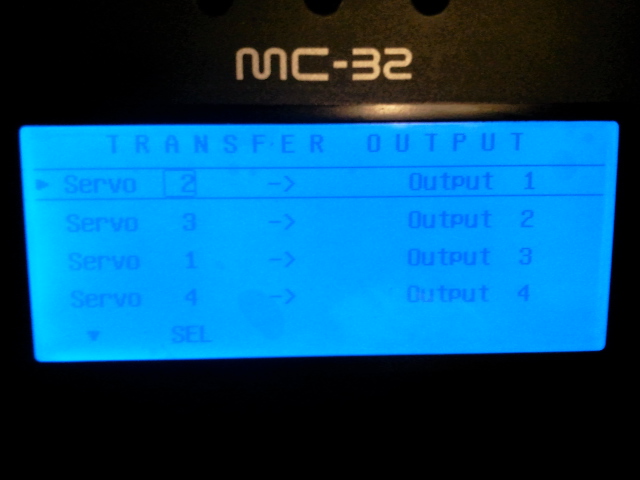

elossam
View attachment 7102 This is the channel secuence. Its better to start from a new model memmory to avoid any unexpected mixer or channel specs unintentionally modified. Rest of channels (5,6,7...) are perfectly assigned 5-5, 6-6, 7-7. ..

elossam
As a plane with one servo for aileron only and traditional tail (not V). Heli mode or two ail servos or V tail could be the reasson of your gost mixers. I use the right three position switch for flight modes, the right long switch with spring for RTH and two sliders on the center for tunning the gains. One of the is exchanged later to use the carefree and POI modes.
