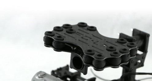

Dear All,
Quick question. How would you attach the below gimbal to a DJI F550? ie. Which landing legs would work the best with the least amount of drilling.
Alex V

Pretty much you would want it mounted in the middle of the bottom frame mount but the 550 frame mount also does the power distro, you could swap the power distro to be the top plate or make a flat strip to mount between two opposite arm mounts using a couple of short standoffs.

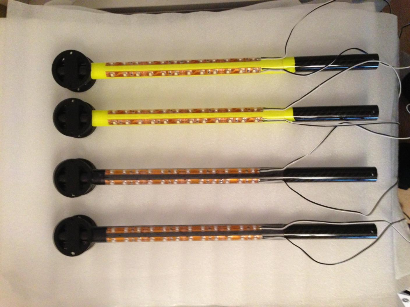

Still looking at what legs I am going to use with mine but depending where you are the colourful ones from gothelirc.com would probably be a good choice, they will not send these to Australia so cannot give them my money anymore but if you are in the US then they look to be a good choice.
