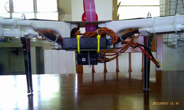

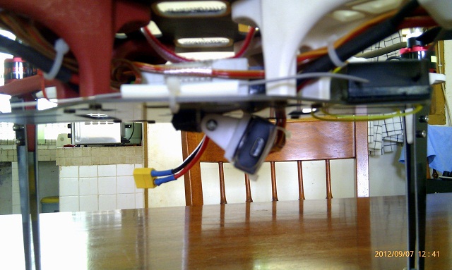

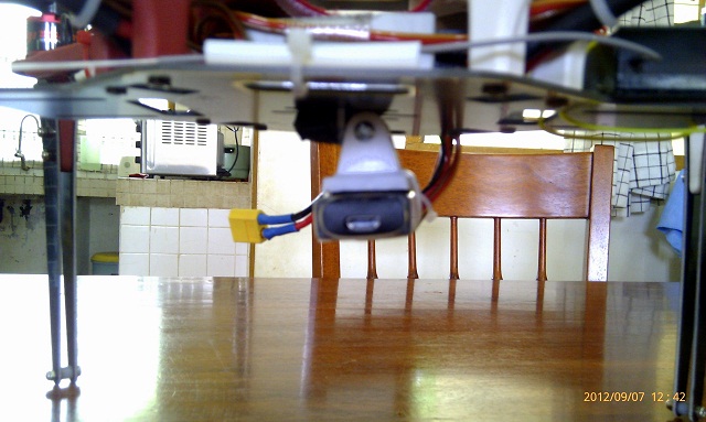

cpmboy
w/o leg extensions , I just put it on the side arm,
w/t leg extensions, below lower plate with the ability to be pivoted...

cmpboy, if you dont mind me asking - what the benefit of being able to pivot? little easier to plug in I suppose?
cpmboy
easier to point the VU to which direction either toward the rear@front (easier to see when doing setup or low hovering) or just directly below (during flight......)
