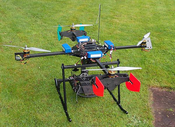

Axi 2826/12 motors are probably more than you need. 2820/14's will spin 14" props. At this weight you might need to consider supplementing yaw control - see attached image. The servo-controlled "rudders" provide yaw control (and mean that you don't need counter-rotating prop pairs).
