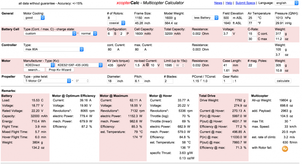

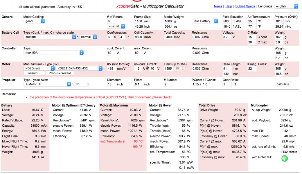

Trying to work out the best way to go... either 8500 or 10000 mah with 4 in parallel or 16000 or 22000 mah with 2 in parallel
Ive done an ecalc on each using Tattu 10000, 16000 & 22000mah as well as the Vulcan 8500mah superlight.
I'm not totally convinced what ecalc is telling me - I'm not fussed on the actual flight times it's giving me just the difference in times it thinks between each setup. With the same total battery weight & mah it thinks 2 in parallel compared to the equivalent setup with 4 in parallel will require more throttle & more flight time?
If anyone could shed some light on this and which is the best setup that would be greatly appreciated.

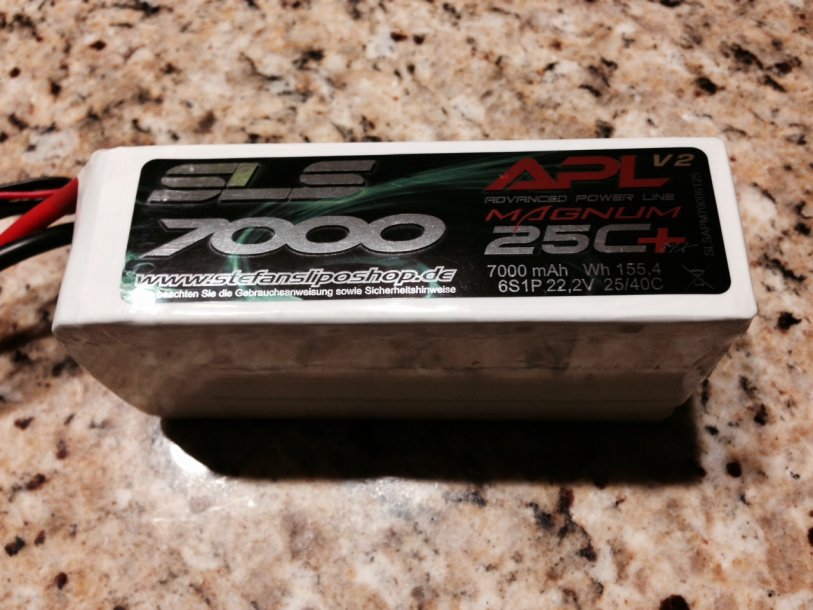

My Tarot X6 has a built in pdb, I'm not a fan of it but that's what you get with a kit like this. It comes with one XT150 or AS150 (not sure of the difference at this hour) but I'm made an extension cable with EC5's for ease of use and finding them locally. I just bought a couple SLS7000 6s batteries to replace some beat SkyLipo 5000 6s I've been using. They look pretty nice, compact size and weight, measure about the same size as the 5000's and weigh just 100g's more each so I think the weight to power ratio is acceptable. I made a pigtail from 10AGW to run two in parallel, same gauge wire on the leads coming off the pdb. Hopefully it will be an improvement from what I have now.
