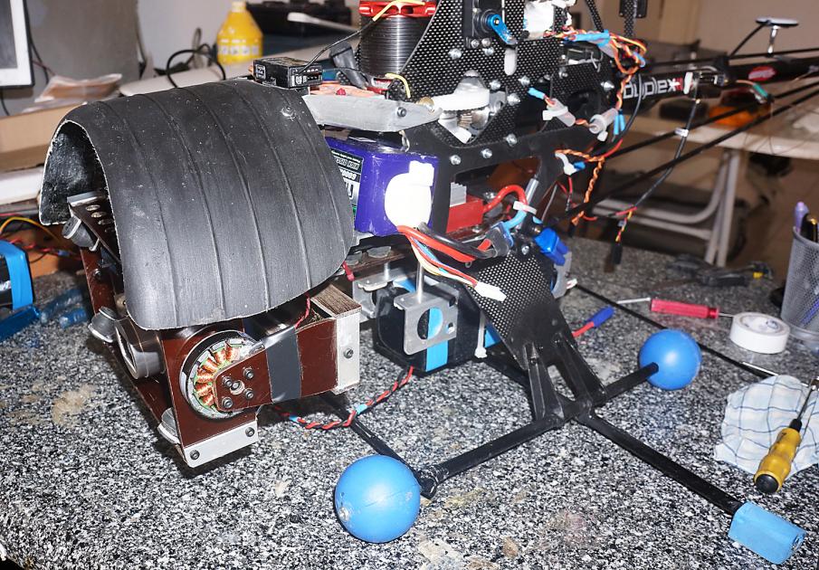

If you want to be totally confused then there are quite a few MR's that can do a reasonable job if you know what you are doing. The fact is that almost all MR's have some level of instability in certain flight conditions. If you fix one end of the envelope then the other end will suffer. It is basically due to one factor and that is that the control concept is based on a fixed pitch prop. that is controlled by an increase or decrease in RPM. The level of reliability is far from that which is considered anywhere near that which should be allowed to fly in a pubic place for hire or reward. It is however possible to build a variable pitch MR device that is based on current SR technology controllers. However why punish yourself with that idea when it would still be well short of the lift efficiency of a well made conventional Single Rotor Helicopter. Something like this will beat any Multi Rotor on Efficiency, Reliability, Stability, Camera Position, Ease of Orientation viewing, Cost and now with some good controllers they are just as easy to fly as MR's. As far as Danger goes it is about 99% less likely to fail from Electrical problems which are the hardest thing to predict and in the event of a power failure they can autorotate. View attachment 11863IView attachment 11864 I built this one for less than 3K:tennis:
I see the penny has dropped with some of your favorite MR dealers
For those who don't understand the aerodynamics of the MR weakness, it is in a nutshell to do with the fact that a descent starts with a slowing down of the blades which in conjunction with a yaw input will cause the slowest blade to begin a partial stall. If you fly a SR helicopter in a non idle up (non constant head speed) then it too will encounter a descent wobble when the blades start to reach the critical angle of attack.
If you want to be totally confused then there are quite a few MR's that can do a reasonable job if you know what you are doing. The fact is that almost all MR's have some level of instability in certain flight conditions. If you fix one end of the envelope then the other end will suffer. It is basically due to one factor and that is that the control concept is based on a fixed pitch prop. that is controlled by an increase or decrease in RPM. The level of reliability is far from that which is considered anywhere near that which should be allowed to fly in a pubic place for hire or reward. It is however possible to build a variable pitch MR device that is based on current SR technology controllers. However why punish yourself with that idea when it would still be well short of the lift efficiency of a well made conventional Single Rotor Helicopter. Something like this will beat any Multi Rotor on Efficiency, Reliability, Stability, Camera Position, Ease of Orientation viewing, Cost and now with some good controllers they are just as easy to fly as MR's. As far as Danger goes it is about 99% less likely to fail from Electrical problems which are the hardest thing to predict and in the event of a power failure they can autorotate. View attachment 15111IView attachment 15112 I built this one for less than 3K:tennis:
