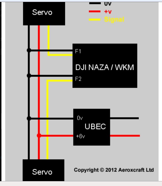

I have one question. removed the signal wire from the servo's connector and put it into empty servo connector. Y from black ground put it into servo connector then plugs into controller. Two powers wires to Ubec. Where do I find wiring diagrams picture.

If wiring two servos to Y-harness plugs UBEc? How many amps output?

I cut my power wires coming from the flight controller to the gimbal servos. Then just solder the bec output to the power wires of the servos. It's pretty easy really. I also added the negative from the bec to the ground of the servos as well.

Both cut + and - wires from the flight controller to the gimbal servos?
Zzr
F1 and F2 black wires to servos?

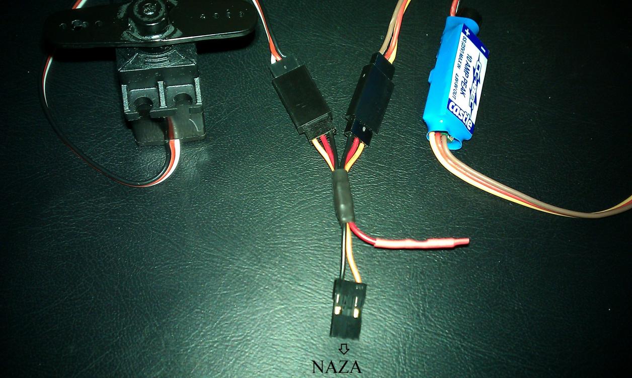

I just got UBEC and Y-harness. I removed Power wire from Y-harness. Is okay this picture?

Should I cut orange wire (signal) from UBEC? I leave for + red and - black wires.
