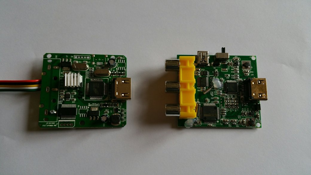

Here is the Kopterworx version on the left vs the ebay one (on the right) I got that doesn't work. Notice the boards are totally different. The one with the 2 capacitors and the heat sink is the one that you want.
I plugged it in. It works. View attachment 25561

Have you had a chance to try it out? Does it work? I ask because I have the Aerialpixels converter but cannot make it work.
