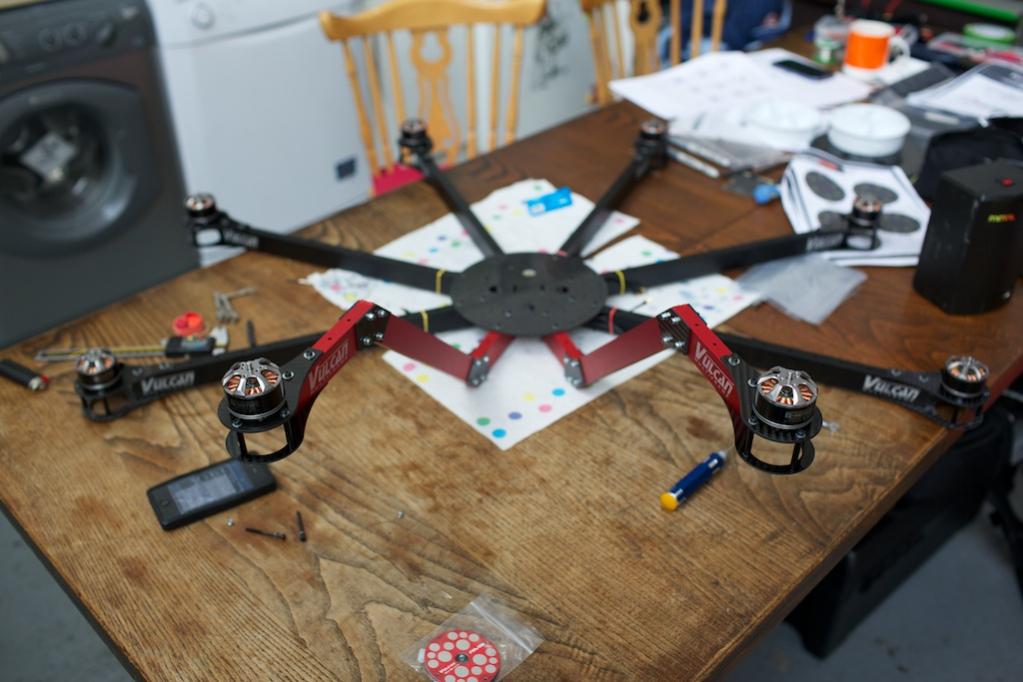

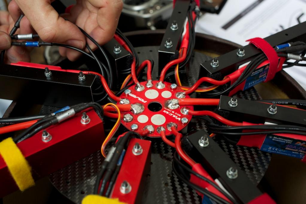

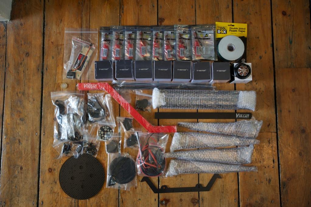

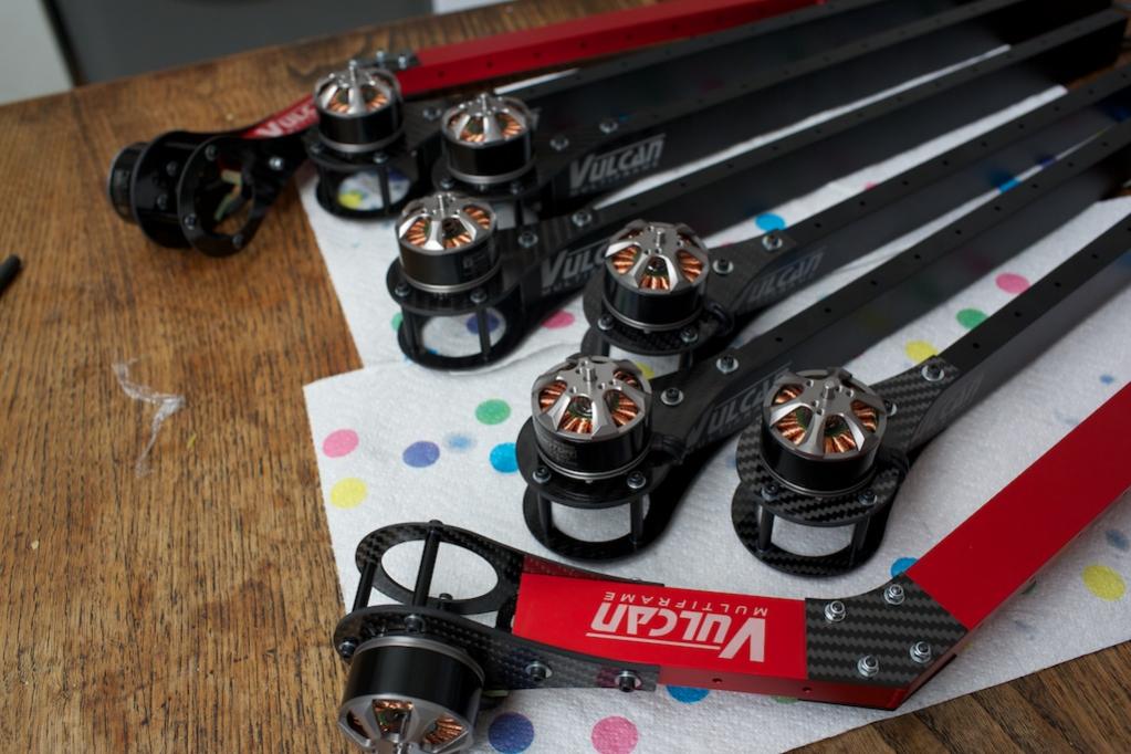

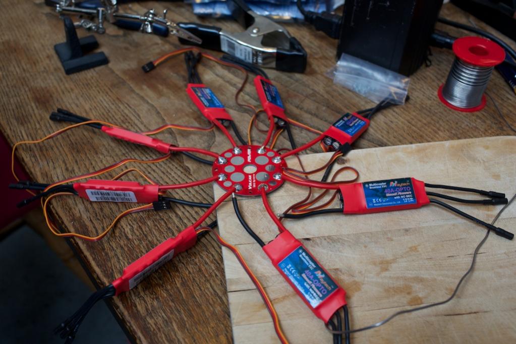

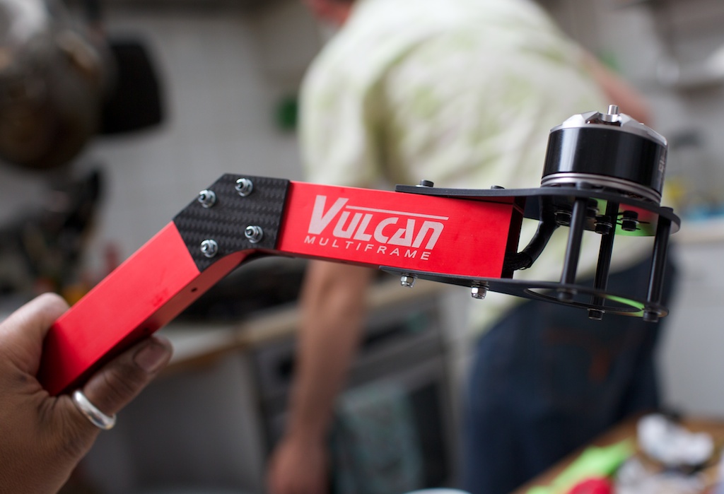

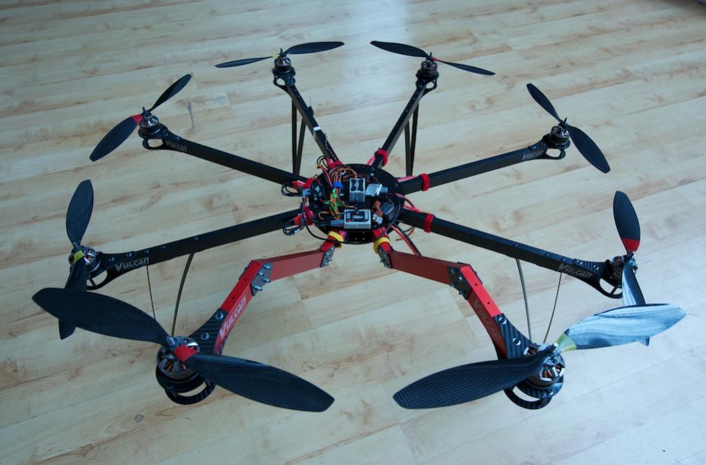

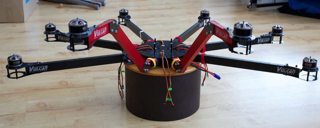

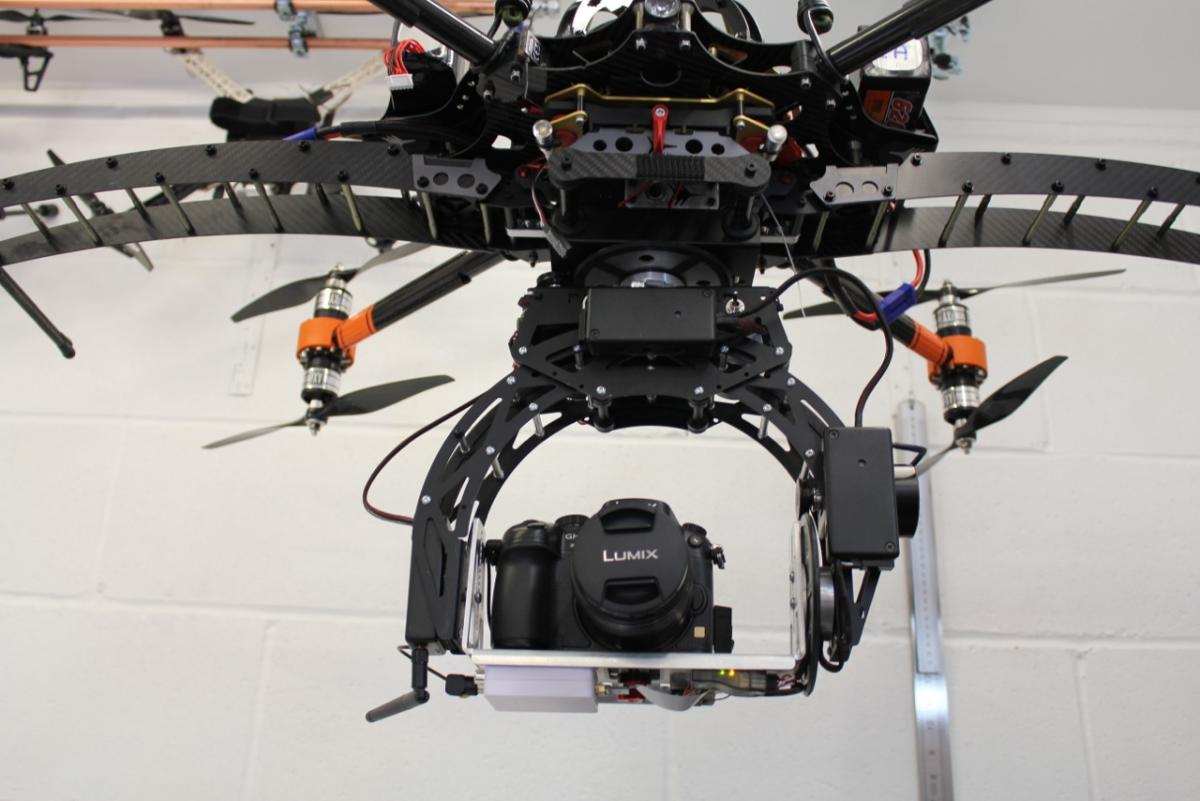

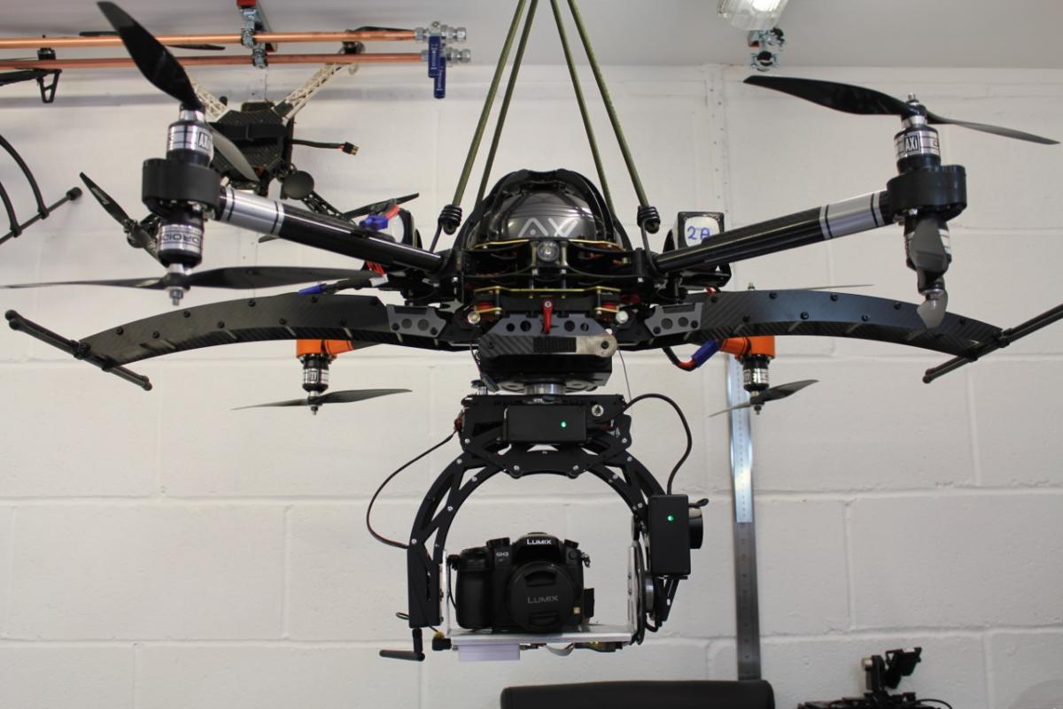

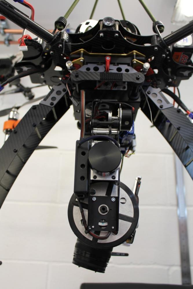

Going into partnership with a fellow professional photographer, after months of interesting research and some fantastic customer service from Alex @ UAVshop.co.uk we decided on the Vulcan Mantis.
The Build was very straightforward (we are both CP heli pilots) and the setting up of the WKM was a breeze, opting for Firmware v5.20 on Alex's recommendations
Here are some build photos:View attachment 12774View attachment 12775View attachment 12776View attachment 12777View attachment 12778View attachment 12779View attachment 12780View attachment 12781
Very straightforward, although if I was building it again, then I would have positioned the ESC power wires to the arms a little more when soldering the PDB
The spec:
Vulcan Multiframe 'Mantis' 1080
Tiger MN 4014 Motors
GemFan 14x4.7 props
Maytech Harrier Supreme 40A ESC
DJI Wookong
Big thankyou to Alex again. If you are window shopping for a multi-rotor, give him a call first.

Hi
I just received the delivery of an Octo Mantis and I am very exited and looking forward to assembling the airframe. Can you please elaborate more on the above comment "I would have positioned the ESC power wires to the arms a little more when soldering the PDB" I am struggling to see what you mean and looking forward to any dos and don'ts !
