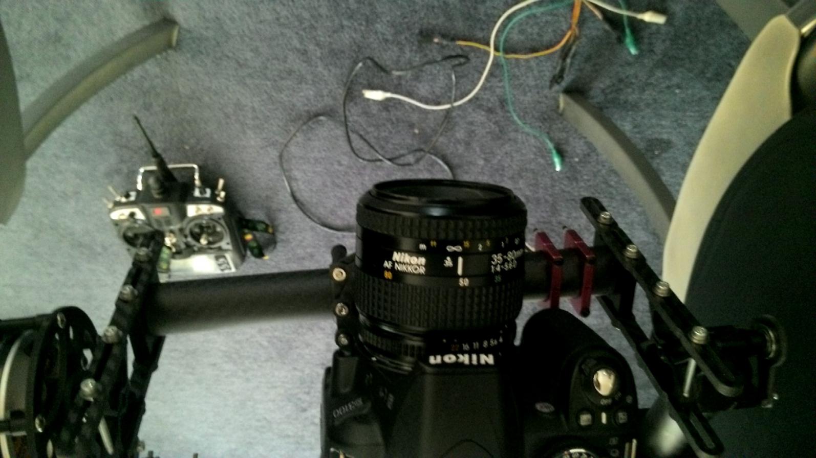

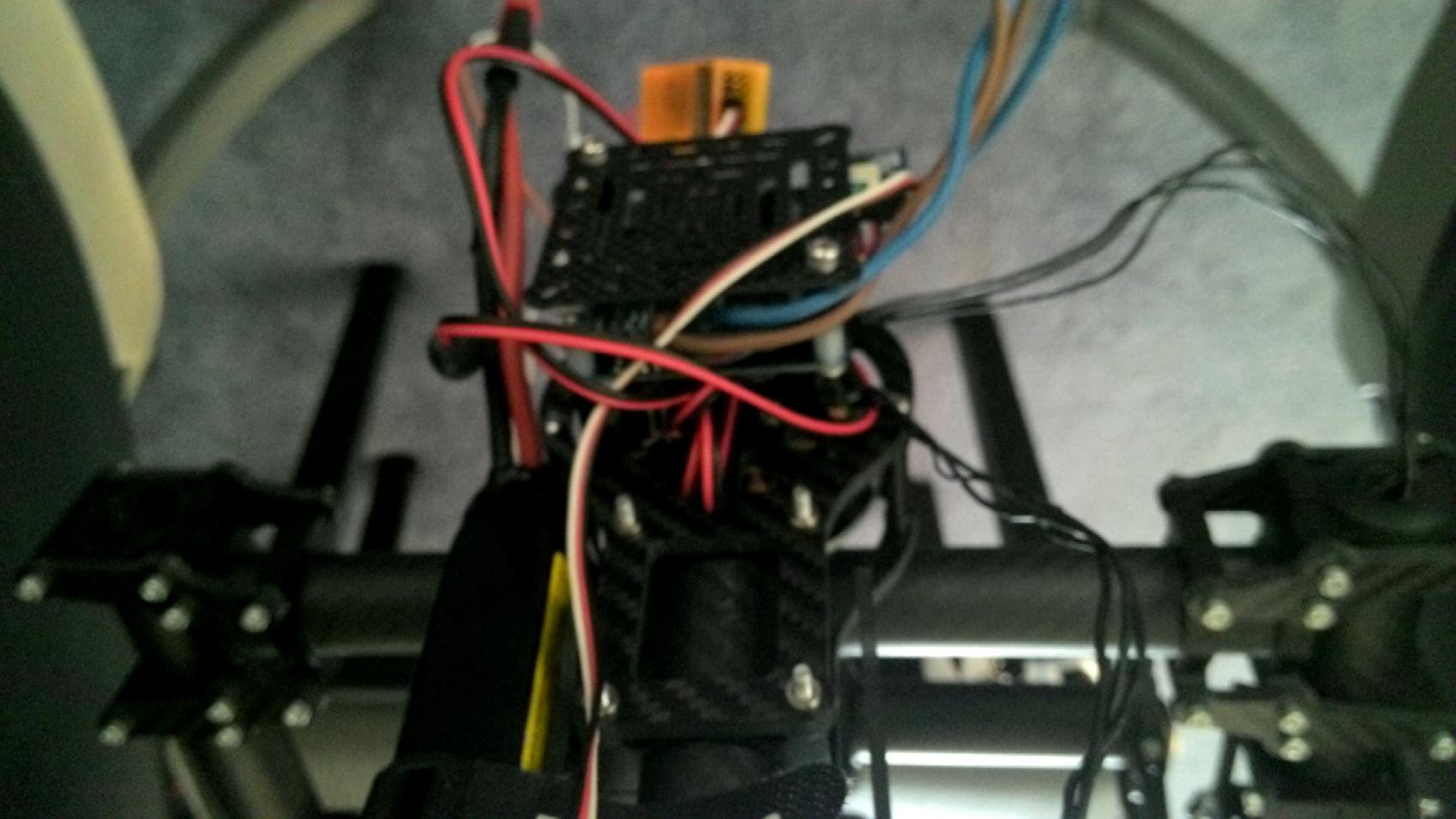

aopen3434@hotmail.com
http://offthegridwater.ca
alexoki
Could you post a better picture or explain a bit more. I do not see a second sensor mounted at 90degrees to the first sensor in either picture.
alexoki
I must be really stupid or you are a terrible photographer! (joking:nevreness:) but I still cant see a second IMU sensor, only the control board!
