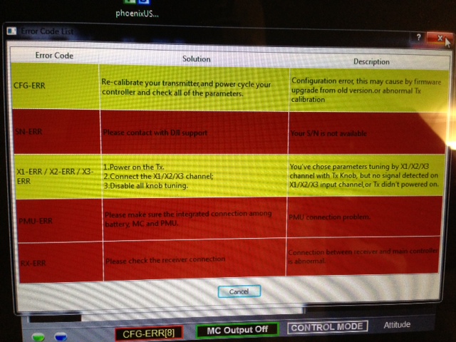

I updated my Naza and immediately got this error. "CFG-ERR"
Anyone seen this before? I contacted DJI, and the response was "Pls do Tx calibration in the software then repower MC".
No luck. Anyone else with this issue?
ThanksView attachment 7276

it's the tx cali, seen it alot. sometimes the receiver type has to be set too, like if your sbus, traditional, ppm, etc

I saw that. I switched to tradition.

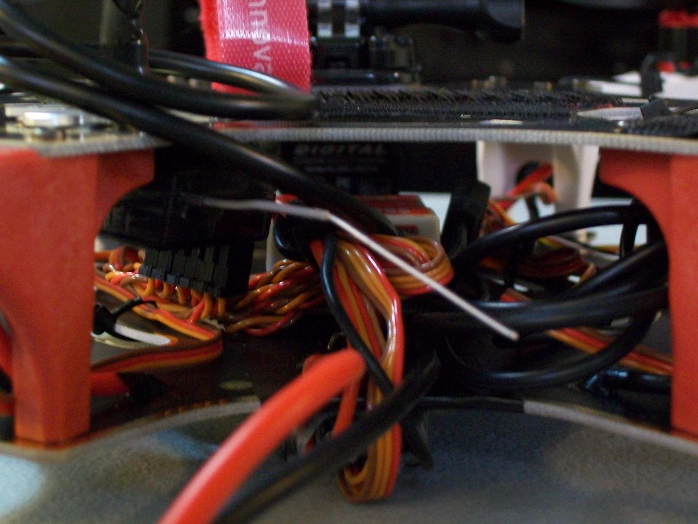

I have my (gimbal)servos plugged into "F1 and F2" with the 360 pan plugged into the rudder on the Rx.(rudder works ok,i guess)

I do have it as close to center as possible, (but down at bottom) Its under the tray (proper side up).
