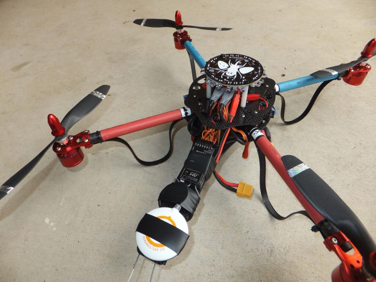

I'm an absolute newbie in Brisbane also. MultiwiiCopter (Gold Coast) from whom I bought my kit from, strongly suggested using double self adhesive gel tape (it's about 2mm thick and looks like a thin slice of green firm jelly. They suggested the NAZA FC + GPS are affected by the strong vibrations. I added a tail frame to attach the GPS puck & Rx having found the gel adhesive not to be strong & have wrapped insulation tape around it to secure it.
Should catch up at Dakabin & exchange notes on set up. I have a Futaba 18MZ & seem to be on my own with working out set up for the NAZA.:) View attachment 12238
