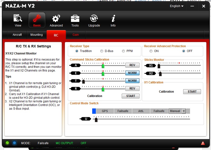

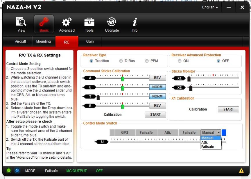

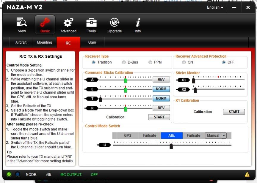

I have it controlled with the 3 position flap/gyro switch on the Dx7s but it seems that the endpoints are off.
I have attached the following pictures:
1. Gyro in mode 1
2. Gyro in mode 2
3. Gyro in mode 3
As you can see it appears that only mode 2 selects an actual flight mode and 1&3 are outside the range.
View attachment 15004View attachment 15005View attachment 15006
Also isn't there a way to set it to GPS mode? I haven't calibrated the gps yet so maybe that is why its disabled.

What you are going to have to do is use endpoint adjustment. You just increase or decrease the end points to get the sliders in the correct position. Once you do this, you will be able to get into GPS mode and GPS / Compass calibration.
