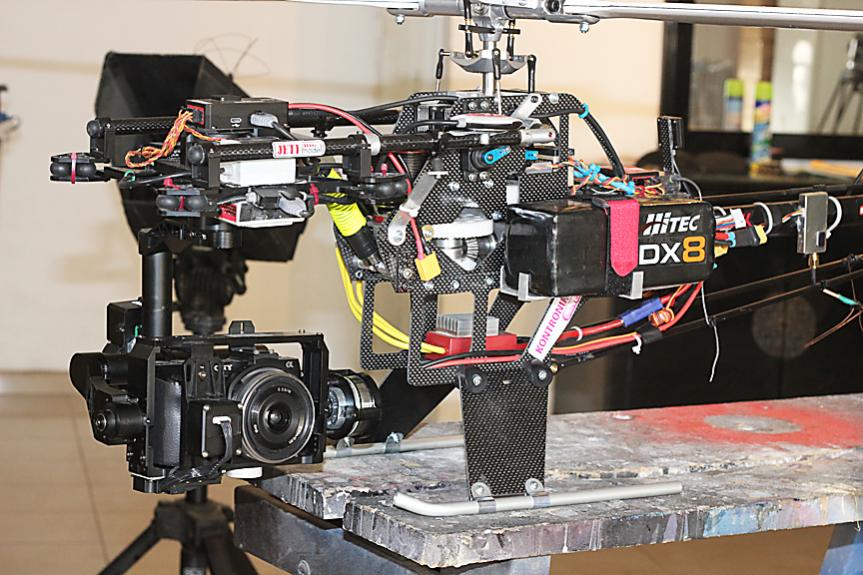

View attachment 8179This is by far the most effective cameraship that I have built and it uses two 11000 maxamps in series FWIW.
View attachment 8181 I think for a S800 and two 11 amp batteries you would need 15x4.5 props. or even 16" with the tips cut back slightly. The question is Do you really need more endurance, most jobs can be achieved with 15 mins flight time and less stress on everything.
