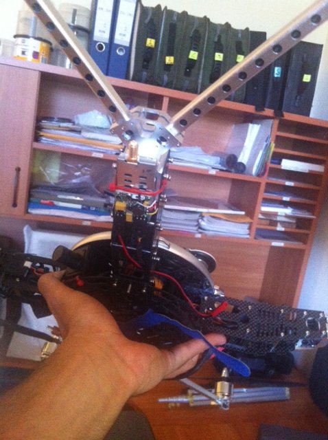

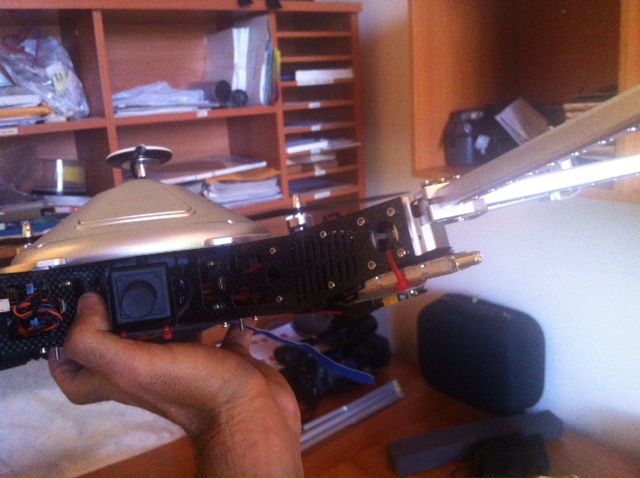

Hello there, I just got an Ace X88, alware gimbal, DX18, DX7 dual operator setup about a month ago. We have been doing some test flights (slowly getting to know it, we live in Costa Rica and there are hardly any big multirotors out here).
We have been pretty happy with the results, from sea level to higher altitude (1700 meters), and in windy conditions. We get about 5mins out of every flight (with an alware gimbal and a T3i with an 18-55mm lens). Waiting on 8000mah batteries due this week to see if we can get 10min flight time.
Being so new, we got the 5.8GHz tx/rx setup for the DSLR and monitor for the cameraman, and got a 900MHz, lowpass filter FPV goggles and minicam setup for the pilot not knowing about GPS conflict. I am in several forums trying to finds someone who has both setups without GPS interruption, not much info on that. We are still in testing and will keep everyone posted on results.
We did run into a problem last week where at mid throttle there was a noticeable split second interruption of power, I emailed DJI with a video with no feedback (been weeks) and wow hobbies can't see a problem either in the video. Yesterday finally one of our rotors lost power (not completely) but obvious that it was not running at same rpm. We replaced the motor and the problem persists. Just wondering if anyone has had an experience like this? We now think it may be the speed controller or the wookong. This is a bummer since we are in Costa Rica where there is nobody with knowledge of octocopters. Any ideas?

As to your problem you might want to check the stability of your boom arms. I had one motor giving me some problems and then when I carried the craft I noticed the arm was a little loose. I felt the motor and it was very hot while the others were cool. I tightened the boom up and problem went away. When you experience the problem do you check the motors and is there a temp difference between them?

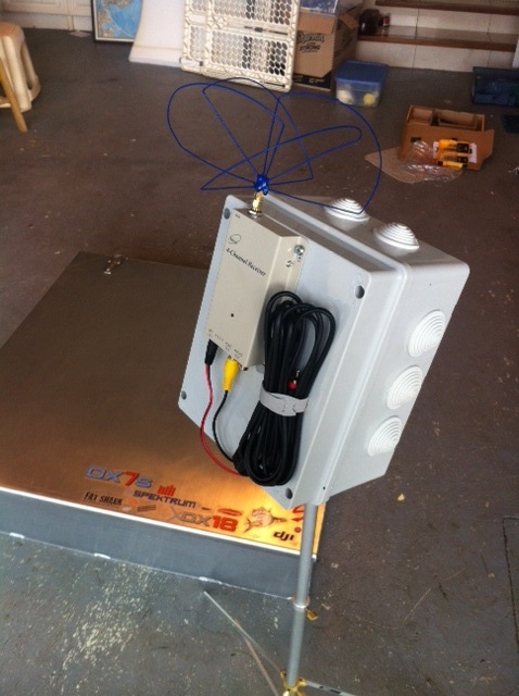

Our GPS has been working very well, the issue is having both 5.8GHz and 900MHz systems running at the same time. The 5.8 is not the problem, it's the 900MHz. We need for the pilot to see where he is going and the cameraman to see what he is filming. DJI said the 900MHz system will definitely interrupt GPS. I placed it as far from the GPS, IMU and receiver as possible and will point the antenna downwards and then run some tests to see if we get purple LED light (GPS locked) grounded from far away. Here's how I set it up (900 MHz tx)
View attachment 12010View attachment 12011

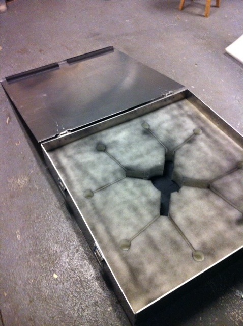

Some photos of a base station and a monster aluminum box I had made to transport the Ace.
View attachment 12012View attachment 12013
